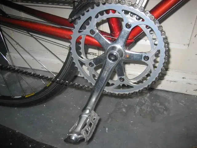

I'm restoring a 1984 Batavus Criterium bike which has Shimano 105 (Golden Arrow?) groupset. It is fitted with Maillard cxc french threaded pedals.
The problems I am facing are:
1. I don't have the clips for the pedals. I have seen some on French ebay for about 20 quid or so. But even with these toe clips my shoes (shimano SPD type) probably wont fit very well. I would like to fit my spare SPD pedals but this would mean rethreading the cranks then I won't be able to refit the Maillards so the bike won't be original.
I thought about buying another crankset off ebay, but I'm concerned they won't be compatable with the axle, frame, bb etc. There seems to be so many different axle tapers, lengths, chain sizes etc.
2. I find MTB cranks seem to be "bent" outwards if you know what I mean, in that the pedals are thrown outwards away from the axle. I find this more comfortable than the straight road cranks as my legs, particularly the right one tends to point outwards, and when my foot is forced straight by toeclips and straps, and a straight crank it hurts my knee after a short while. I saw this:
http://www.ebay.co.uk/itm/171487491779? ... EBIDX%3AIT
on ebay. will it be compatable? I have a 7 speed cassette on the back and a standard chain.
Can I place a washer between the pedals and the crank to space the pedal outboard a little bit?
I also like the idea of a smaller inner ring to help me up the hills around here.
All advice much appreciated.
Phil

The Maillards are French threads - 14 x 1.25mm. Standard threads are 9/16" (14.23 x 20 TPI (1.27mm) ((apparently)). The pedals will loosely fit in a normal crank, but normal pedals bind up within 1-2 threads going into these cranks. Once I re-thread them I can't go back to the original pedals, which seems a shame as most of the other components are original. (or maybe it doesn't matter that much).

For myself while the CXCs are nice pedals there are plenty of other nice 9/16 pedals you could fit if you wanted to make the bike more authentic again and it would save having to find the toe-clips too :wink:

Has Shimano really made cranks for "french" pedals?
And yes, it's ok to use shims/washers.
