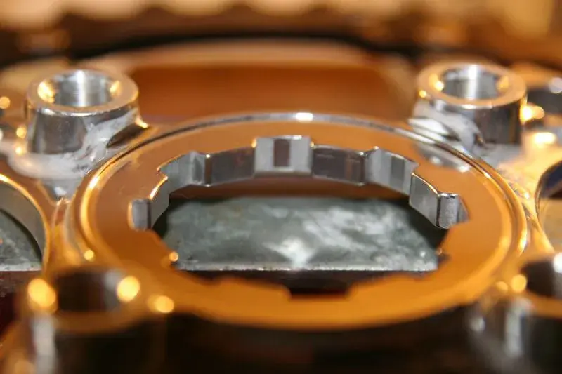

First the good news...
As others have mentioned it's M569, and all but identical to XT M739 cranks, lock ring attachment seems to be the same as XTRM952.
New outer rings are available:
http://www.ebay.co.uk/itm/New-42T-C...&otn=5&po=LVI&ps=63&clkid=9128242487654208765
TACX make a removal tool: Tacx Chainring Lockring Tool -T4470, though I paid way less than what google is showing:
http://www.google.co.uk/search?tbm=...09.2.2.0.0.0.0.78.156.2.2.0...0.0.l0dvtMTEm7U
Now the not so good news...
I have two M569 chainsets (one owned from new on a '98 Kona) with the original outer chainring. And now two NOS outer chainrings.
At some point, shimano changed the design slightly - on the new rings, there is more metal machined/forged/what-ever away where the lock-ring attaches. This means that the ring part of the engagement is now thinner than the crank part. Lock ring tightens against the crankarm , not the chainring - part 4 onto part 9, not part 8 here:
http://www.shimanoservicecentre.co.uk/SSC/shimano_parts/Front Chainwheel/FC-M952-4.pdf
Hopefully the above makes sense, will try and get pictures up this evening of the difference.
It's less than 1mm needed, but a BB spacer (M952) is just a fraction too small - won't clear the engagement teeth on the crank, fine for thickness but not internal diameter.
If anybody as a suitable washer/spacer - ID ~35.6mm OD~42.5 (will check) and around 1mm thick let me know.

Pictures of "original" top, and "NOS" below...
The ridges on the old are just marks from the lock ring. The washer/spacer would need to have an ID sufficient to clear the "locating teeth" indents, but OD to fit within the outer lip - ID35.6/OD42.5mm x1mm.
I've emailed Madison to see what they say.
