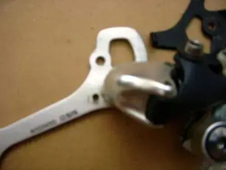

Copey Retro Guru Oct 3, 2008 #1 Chaps, I hope you can see the pin thingy holding the tension in place has fallen out of an otherwise very nice and clean XT rear mech.. I would hate to scrap it.. I wanted it for my winter bike... Any suggestions? Cheers mark Attachments rear mech 004.webp 6 KB · Views: 1,077

stew-b Senior Retro Guru Feedback View Oct 3, 2008 #2 the top hole is for the jockey wheel bolt,the lower is for a stop pin that does nothing at all unless your chain ever snaps.

Copey Retro Guru Oct 3, 2008 #3 So, the chain keeps it tensioned unless it snaps? If the chain snaps, then the rear mech will go "boing" and dig into the frame a bit..?? I guess thats ok..

Iwasgoodonce Old School Grand Master Oct 3, 2008 #4 You should be able to bodge something with a Mechano bolt or something similar, or even a pop rivet.
T tenbikes Retro Guru Oct 3, 2008 #7 I don't know what you used, but I did the same bodge with one of the little 'bolt' thingies that adjust the reach in brake levers

legrandefromage Bin Monkey BoTM Winner PoTM Winner GT Fan Feedback View Oct 3, 2008 #8 check out older shimano mechs, the stop is threaded and they fit later models such as this one.
