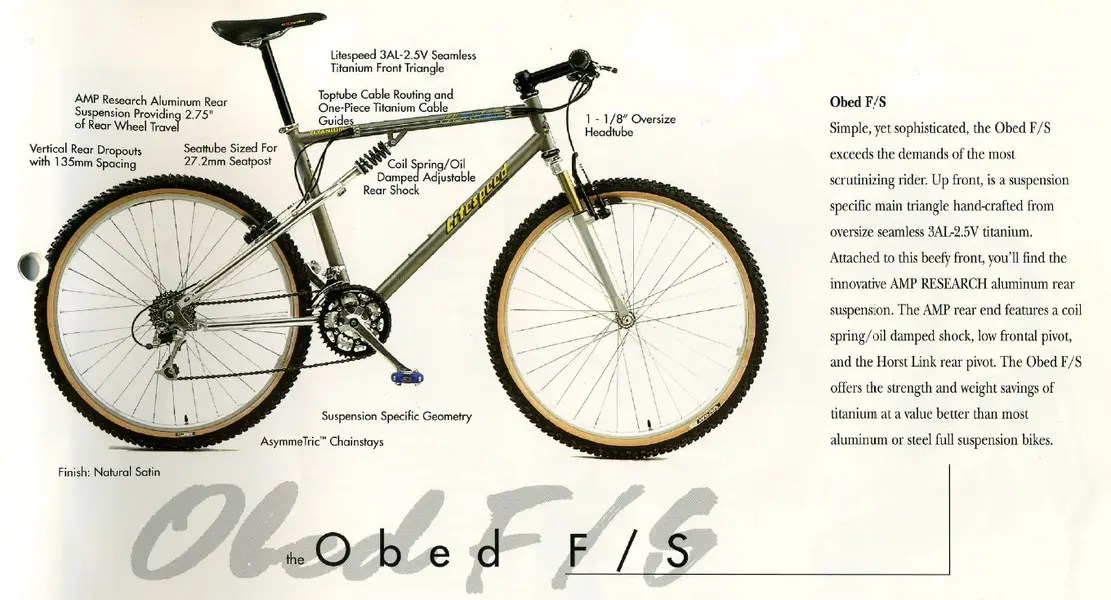

is it a 95 model with polished AMP rear end?
there was also a 96 model with yellow AMP rear triangle fitting perfectly to the used yellow Judy Fork.
If yours has a silver/polished rear triangle, I would suggest to have also a silver fork.
If you're thinking of optimize the build for better performing parts, I would recommend to consider also a bit of a later generation suspension fork.
E.g. a polished end of 90thies Bomber or silver early SID would be a good fit, from the look and performance-wise.
Just take care that axel-to-crown hight isn't too strongly increasing, which may have negative impact.
Some early SID models with 63mm travel are still just 45cm. This is already 4cm more compared to RS MAG or AMP F3.

Nothing I can think of will be period correct on this build aside from frame, and maybe forks. Seems a mad thing to say given the reputation of amp derived frames but the mags are a bit on the flexy side. The forks pictured in the brochure posted above look a bit weedy against the ti tubes frame and I suspect the mags would too.
