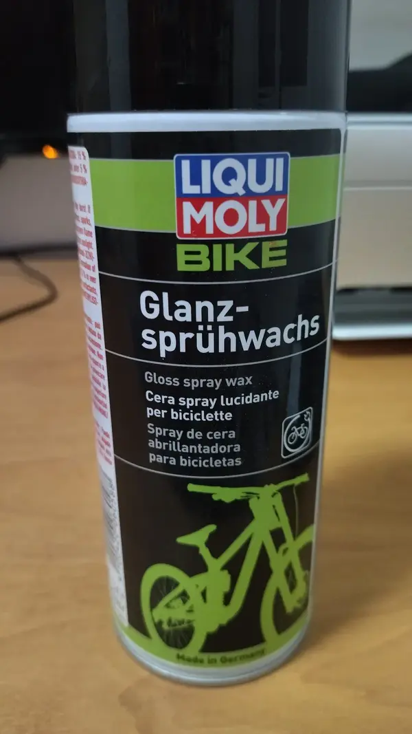

Just tried this spray wax today.
Results were similar IMO to the regular wax I have (Dooyo with little carnuba) but much easier to apply. Important to wipe off excess before gets dry otherwise takes a lot of time with the microfiber to remove it.
I guess the key to get better results is to use a rubbing compound before wax to get more shine but I was afraid in my case as there are old decals and condition is already fair to me.
Happy not gone with the ceramic coating, can't imagine how to remove excess!!! Thanks for the advice again.
