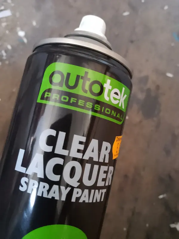

I've been using this .... It's about as tough as you'll get from a spray can.....really thin coats is the key.
Automotive is what we are talking about above.....2k is a different kettle of fish in terms of use and durability.
