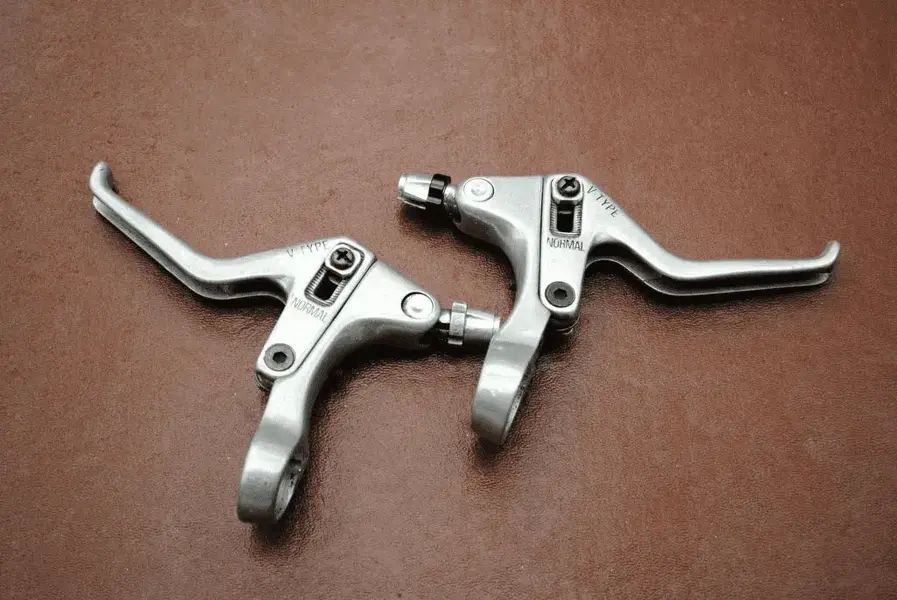

I had a dig around and there are some for a lot less on ebay - some mid-20s in used condition - they were designed at the crossover from cantilevers to V brakes - the STX Vs were lovely things - very simple alloy ‘wings’ - and would look great on your frame - BUT there is indeed a view that the adjustable leverage position meant that they were designed to be interchangeable between Vs and cantilever brakes ... that’s what I recall from the time I was using them. So I think that’s a ‘yes’.

The frame I've got is designed for canti, it's got the bridge on the frame, the STX levers are definitely something I'll consider though and will keep a lookout on eBay and on here.

Thoose STX are for V-Brakes* started in 1997 in the STX-RC groupset, but not yet in the STX groupset,
there is of course a combi STX for canti.
1995
https://www.retrobike.co.uk/gallery...o+Archive/Catalogues/1995/1995+-+STX.jpg.html
and -RC https://www.retrobike.co.uk/gallery...rchive/Catalogues/1995/1995+-+STX+RC.jpg.html
or 1996
https://www.retrobike.co.uk/gallery...o+Archive/Catalogues/1996/1996+-+STX.jpg.htmlhttps://www.retrobike.co.uk/gallery...rchive/Catalogues/1996/1996+-+STX+RC.jpg.htmlThey don't have servo-wave as you know it for Canti brakes.
For that you really need XTR M900/910 or XT M737
OR the not often seen M564 (and is 7speed too) which may be a rehashed DX combi shifter) . You're more likely to see the M563, which lacks servowave and has a more STX styling from above, but it black. Both 1995.
*You may be able to pick up the newer but still the same 2009 era LX version BL-M570 M571 for cheaper.
Yep, for v brakes.
Never used the ss6, only the great ss5's and 7's. Have a pair of DC Power levers somewhere if you want them?
Those STX levers wont work very well with cantilevers.
They were NOT designed to ever be used with them
The 'adjustment' is just to trim some of the aggression out of the v-brake.
But hey, its the internet and anything goes these days!
Shimano's low profile cantilever brakes were not very good unless time and patience were used (and who had any of that aged 19??) giving the then new v-brake the chance to send everyone over the handlebars.
These and some Avids were / are possibly the only ever multi use levers. They adjust the cable pull.

And after a dig around found a helpful and quite wide-ranging discussion of this:
https://www.bikeforums.net/bicycle-mechanics/646703-stx-rx-brake-levers-cantis-calipers.html
Re the performance of Shimano low profile cantilevers, I well recall in 1995 being frustrated by the relationship between the increased speed of my newly-purchased Proflex 855 and the low power of the Shimano cantilever brakes. Fettling and new compound pads made scant improvement. Difficult rear heel clearance issues meant little choice - but some Critical Racing cantilevers came to the rescue - very light, very powerful, very nice.
