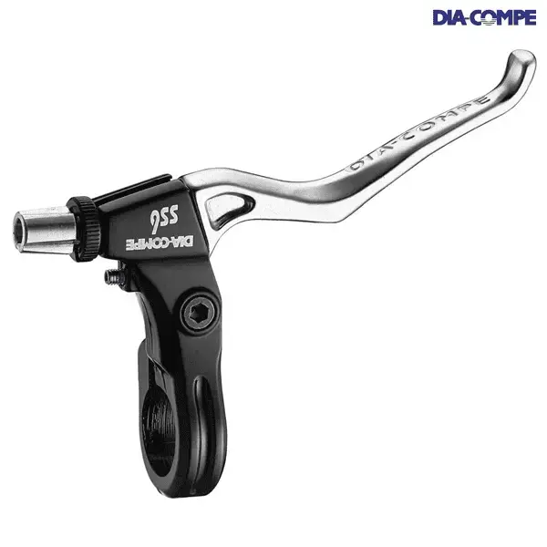

The frame I have dates back to the mid '90s. I've already got an idea on what canti brakes I'm going run and I was wondering if Dia Compe SS6 levers would be suitable aesthetically?

What are your thoughts on the SS6 levers?
They're just a modern styled version of the SS5, so should look fine.
