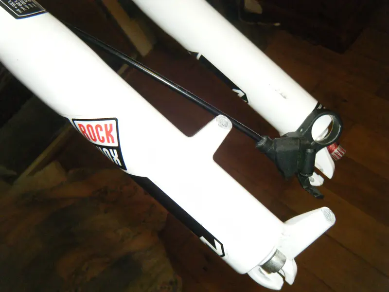

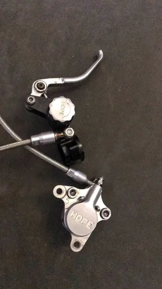

I wonder if anyone can help. I'm in the process of building upa 98 GT Zaskar and I'm fitting some Rockshox Recon (2012) withpost mount. I want to fit a Hope 5 caliper, does anyone know what adapter I would need and what size disc and indeed if anyone has one or the other...

I’ve just replied to you other thread. You will need a hope HBSM20mm which should allow you to fit a 185 rotor.
Or you could try this (and might be easier to find than the hope)
https://clee-cycles.co.uk/P1043/product
The 160-160 should give you a 165 rotor
And the 160-180 should give you a 185 rotor.
Like I said in your other post I will try an check the rotor sizes to confirm I’m giving you the correct info.
Hope C2 No5 is a 165mm front rotor, not 160mm. Post to IS is adaptor HBSM20H
This one seems a bit pricey but its the only one.
https://www.ebay.co.uk/itm/Hope-Disc-Br ... SwDZhfDbBS
You can overcome the extra 5 mm by putting some matching washers between the fork mount and the adaptor.
