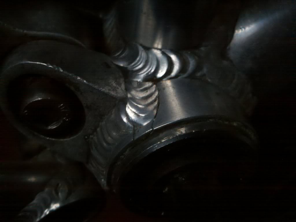

So, merrily pulling parts off, cleaning them etc, all is well, untill... I come to cleaning the frame.
I bought it a while ago and it had had a repair done on the non-drive side BB area but all seemed ok and i've been giving it a reasonable amount of abuse.
Here's a picture of the drive side now
That doesn't look very good to me :cry:
Is that a second crack in that weld? TBH I'm not sure if you'll need a welder or a magician to fix that. I'm afraid that bike is dead either way.
I'd suggest getting another frame and hanging this one on the wall. Even if you fix it, it'll probably have trouble coping with any serious amount of pedal force.

As I said it had been repaired before on the other side, which is still holding, but I wasn't even going to consider more repairs to it.
I will give a clean and polish and call it art :lol:
Just don't think I trust retro aluminium and always seem to sell the one's I start before riding them. Simply can't afford to splash money on a frame that might turn to mince. :(

could you get the b/b shell replaced with a new 7005 one and re welded?

take this to a half decent tig welder and theyd sort it out in 5 minutes, i can recommend somewhere, actually a training college in nw london that will fo this for free!
