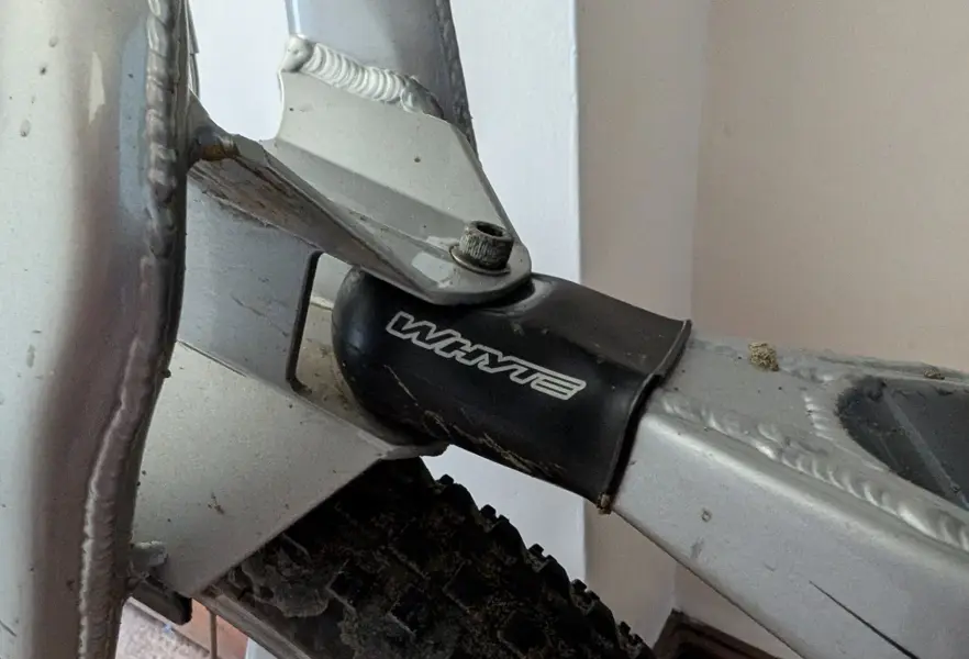

Is there wear on the front linkage in the picture attached or is it meant to look like this?

Hello. Lovely looking bike there, I do like the prst's.
Mine has a rubber boot over the fork linkage as pictured so I can't compare mine to yours...but yours does look to have significant wear. Maybe they all look like this though? I am led to believe that Whyte will replace bearings etc for the prst for life, so prob worth getting in touch with them.
I contacted Whyte recently about an owners manual for my prst and they were immediately helpful and sent me a 2.06mb file withing 48 hrs. I'm happy to share that with u (if there is not already one someone on here) if I can upload it somewhere, or as I say get in touch with them.

Yep, that spherical bearing is toast. New one from memory is around £50. I think warranty only applies to the original owner.
