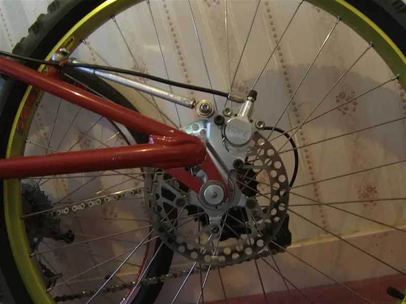

Voila :D The frame mount(On '97 Santa cruz Tazmon) and hope bolt on disc brake frame converter(On '99 Orange Clockwork)

I had to supply a wheel with the disc fitted and a working calliper and lever to Argos, but as I am using mechanical callipers, that was pretty easy to do.
I bought my 93 Vit T having had the same done - you can see it in my Sig.
I personally would have left the brake bosses and seat stay bridge on but horses for courses.
Hope C2's were around enough in the 90's to count as retro and they are still damn good stoppers.
