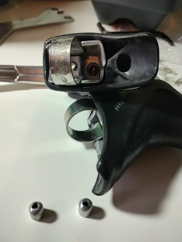

Hi,
I'm looking for help again. Bought these Weinmann levers and am struggling with these wee bits. I'm thinking they go inside, rounded side first, and the brake cable goes through them, perhaps, but how do they stay in place?
Thanks for looking.

Put them on the ends of the outer brake cable/housing and then you should be able to feed the outer cable into the inside of the lever where the inner cable threads through. So, it's the cable housing that keeps them in place. They should be a fairly snug fit on the end of the outer.
Hi again, I realise I bought retro aero levers instead of non-aero. Struggling to work out how the cable comes out of the hood housing to lay against the bars? There isn't any part of the hood that is recessed or of a half moon shape for it to exit from, which I'd expect.

Yes, I can see from your photo that there's no cut-out part for the cable to exit through - you're right, most aero levers do have that. I can only guess that the cable is just meant to go out of the side, at a logical point - it looks like there are areas at the sides where it's just the rubber hood, not the plastic part, so the cable can fit under the rubber hood at those points? I suspect it will be more obvious when the levers are mounted on the bars.
It sounds like you need a new quill stem anyway, if it doesn't fit your bars, so I guess it makes sense to use the levers you have, seeing as your bars have the recess for the cables on them?
I have a quill stem that fits the bars that I have fitted. I've tried to fit these aero levers but it just leaves a bulge when exiting the hood, there doesn't seem to be a logical point. I've realised after purchase that they are Weinmann hoods on a Dia Compe set of levers.

I think to fit these levers, you're meant to drill the bars. A hole where the lever is to thread the cable into the bars and another hole near the stem for the cable to exit the bars (each side of course).
Not something I'd be comfortable in doing or riding
