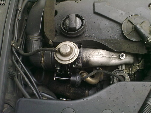

Could also be the Exhaust gas return valve, I disconnected mine but that was on a TDI 130 Passat

Dealer will charge the earth. The EGR can be disconnected very easily. Its just underneath the engine cover at the back. A small pipe, pull it off and that is the EGR bypassed.

Lgf, if you disconnect the egr is the ecu supposed to be altered too so it knows it isn't there?
