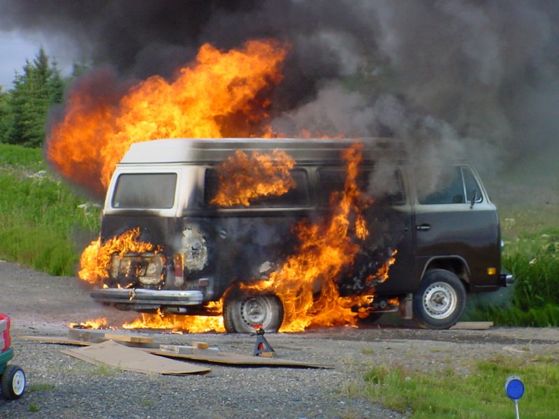

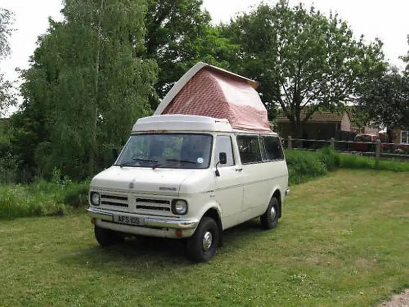

The first thing you should do is replace the fuel pipe above the exhaust manifold. Due to the heat, this has a habit of decomposing and splitting.
You can guess the rest... :roll:
Ssssstreuth!
