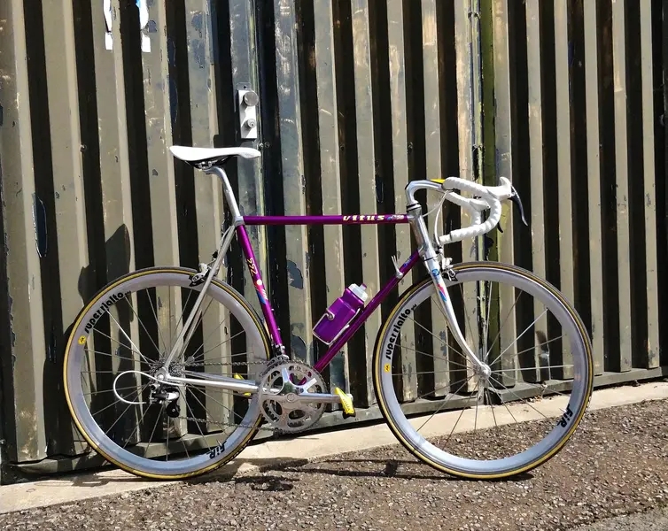

So this little rebuild is pretty much complete. Here are a few WIP pictures, I'll do a little photoshoot when I have a chance.

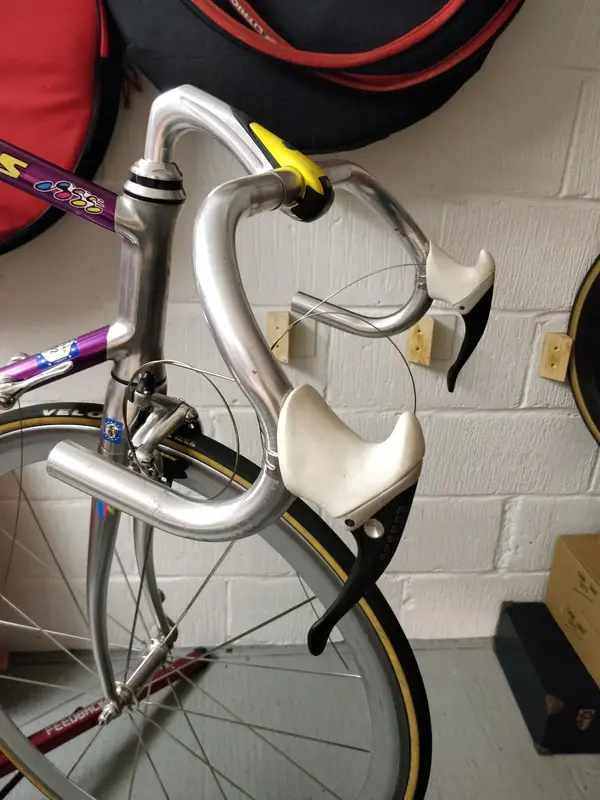

After a bit of umming and aahing I got the bar angle somewhere I'm happy with. These Mavic 350s are pretty different to the anatomic Modolo set I had on the first iteration of this build. The ramps are long and the drops short, but I've found them more comfortable so far.

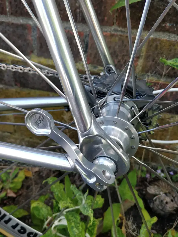

I got a NOS set of PMP skewers to match the hubs and replace the Dura Ace pair I had before. Ti/Alu so super light. ;)

Stem looks the part - I'm very happy with how it matches the yellow on the decals and pedals.

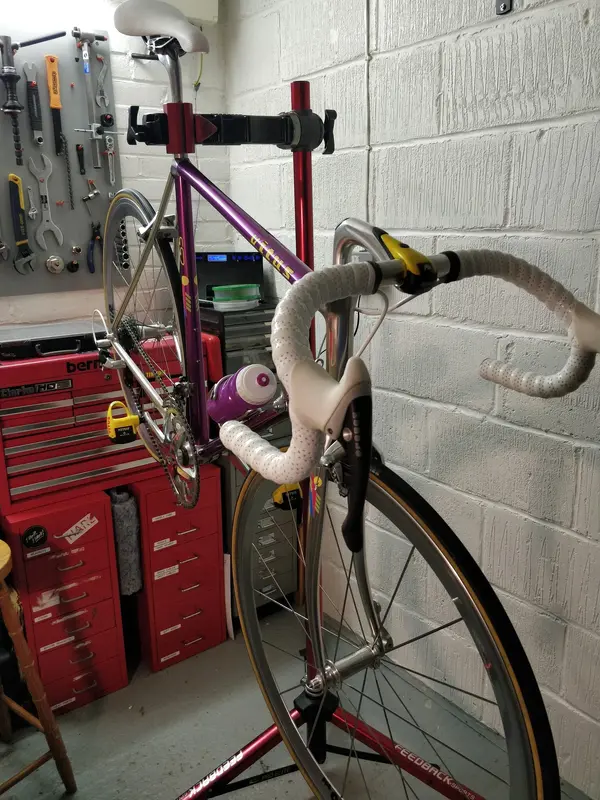

In the stand getting a final bit of polishing and tweaking.

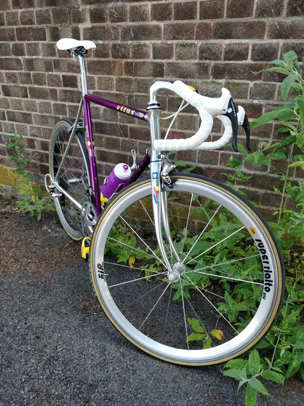

Here are a few more images of the completed rebuild....

Stem - Modolo Q Race
Bar - Mavic 350

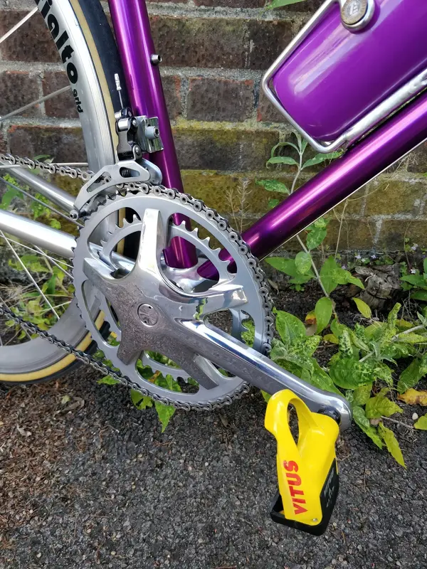

Crankset - Mavic 631 172.5mm
Bottom Bracket - Mavic 610 URD 114mm
Chainrings - Mavic 53/41

Wheels - Fir Super Rialto Grid
Hubs - PMP 8 speed Campagnolo
Skewers - PMP ti long lever type
Tires - Veloflex Master 23
Pedals - Vitus (branded Look F Arc)
Finished earlier this summer, it is super fun to ride. stiff and very quick. Very happy with the improvements I've made - almost 'tout Mavic' now with the addition of brakes, handlebar and shifters. When I see some 440 levers for a decent price I will finally swap out the Modolo pair. The whole look of the bike is improved with the bar shape and angle, and the Flite with the black rail detail sits well I feel.
Enjoy the pictures!
Beautiful. I'm not always a fan of deeper section wheels (even when period correct, as of course these are), but they really work with this frame. And those skewers are quite something!

The skewers are a bit ott! 😄 Might replace with some shorter PMPs in purple if they ever appear.

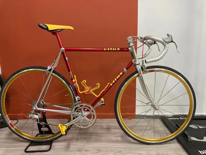

Hi, very nice build. As a Vitus 992 owner myself, it's quite interesting that I also opted for deep section rims and modolo brake levers.
Here's my build: Modolo OXO stem (about to swap it with a red one), Modolo handlebar, Modolo Brake Lever, Campagnolo Chorus 8 speed groupset with Syncro shifters, KMC gold chain, Vitus painted pedals, Gipiemme Tecno 830 laced to Chorus hubs built by a local mechanic.
