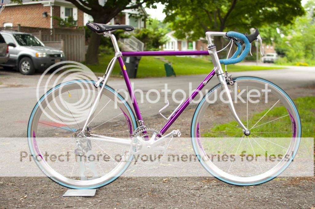

Nice! Here's my Vitus... I went with Mavic as well.. I did a bit of a Mix-Match of mavic groups... even the stem is made by mavic (most ppl didn't know they made stems)...
I like the matching wheels! :)

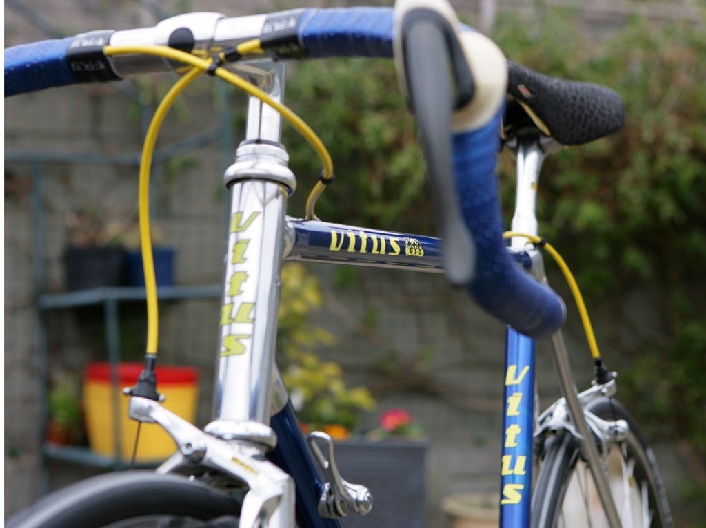

It's really starting to look like a bike again. :)

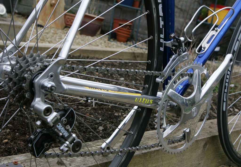

SSC 631 Starfish crankset now polished and fitted.
These are 170.00 39/53 and only needed mild fettling to remove minor marks.
The beauty of the 631 is that they're polished and lacquered from the factory rather than anodised so they're very easy to refinish if required.
The water bottle cage is a stainless 'Moderniste' from velo orange fixed with some nice tapered stainless bolts that I found in the parts bin.
New Rolls saddle.
Not the lightest thing in the world but oh so comfy.
And the new decals arrived from seller Dizzibird on eBay... much better colour this time.
Almost done now.
Originality had to be compromised in the name of practicality so the original Mavic brake shoes went into the archives and some modern Swiss Stop Flash Pro BXP were bolted on instead.
I still need to make a call on gearing.
Options are
a] period correct Shimano 600 13 - 21 6 speed
b] period correct Maillard Corse 14 - 20 6 speed
c] modern Shimano 14 - 28 7 speed
My head says the 14-28.
My heart says the 14-20 Maillard.
My legs say listen to your head. :)
