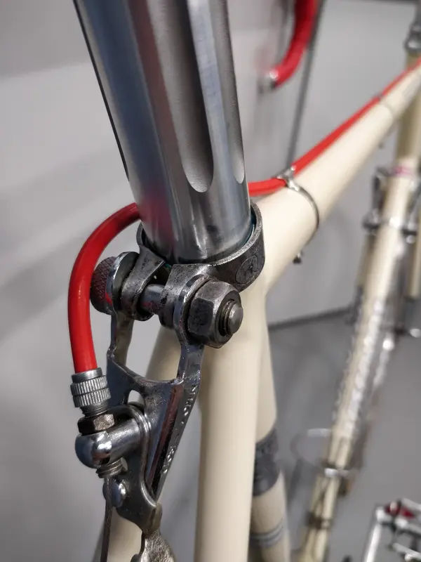

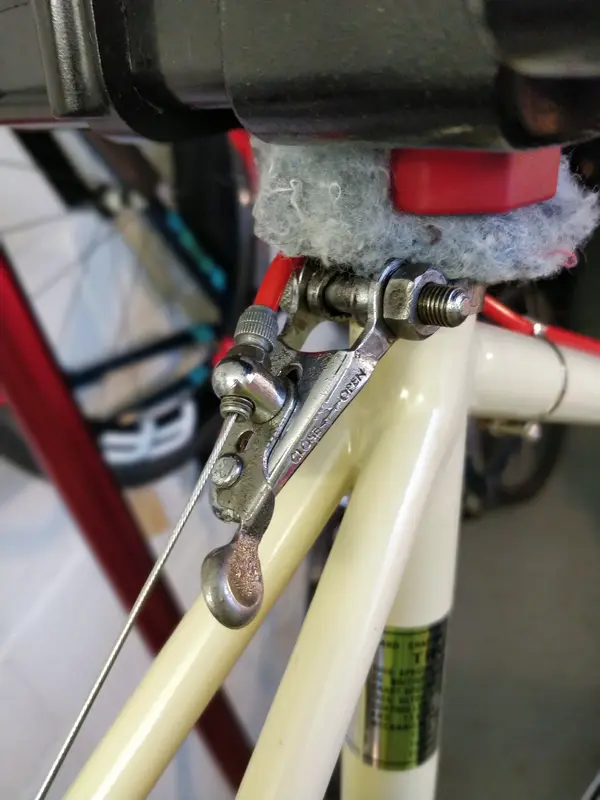

The huge bit of bolt sticking out of the binder clamp was bothering me so I took it out and cut 8mm off...
Before
After 👍

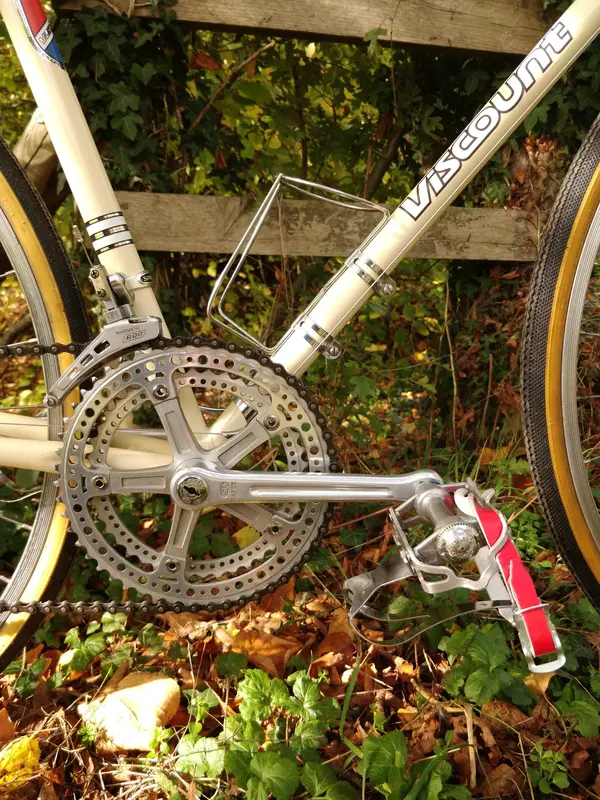

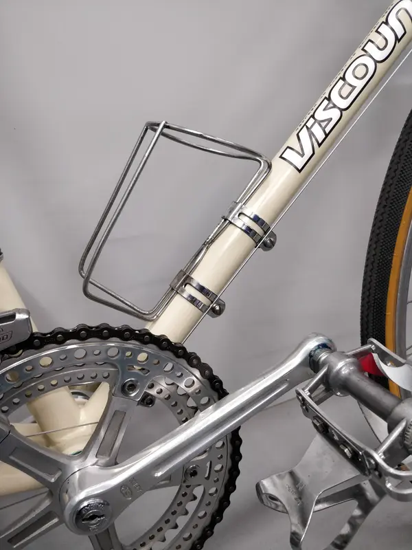

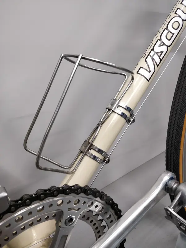

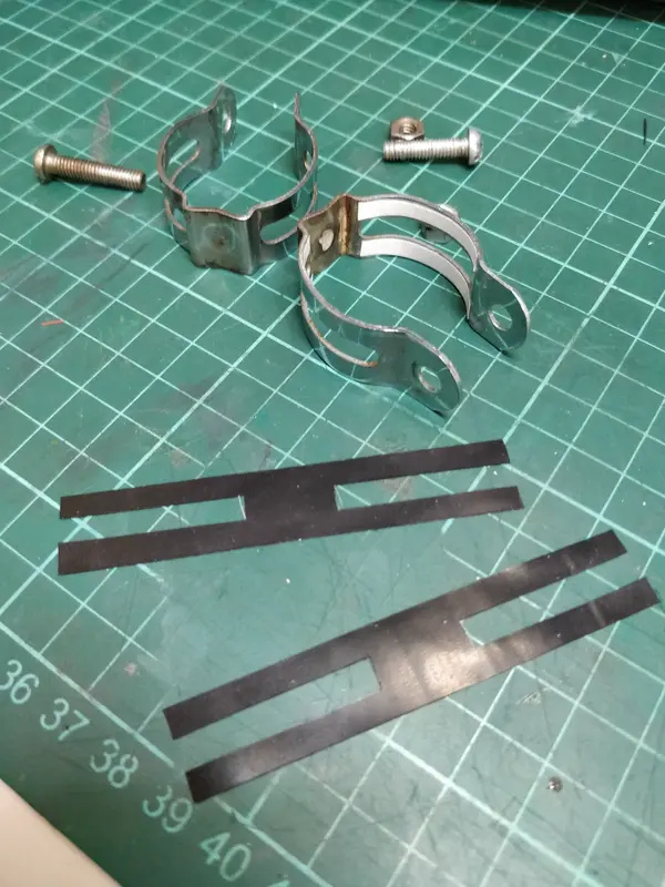

Bottle cage clamps, I made these thin rubber bits to stop them shifting/chewing up the paint.
Cage on.

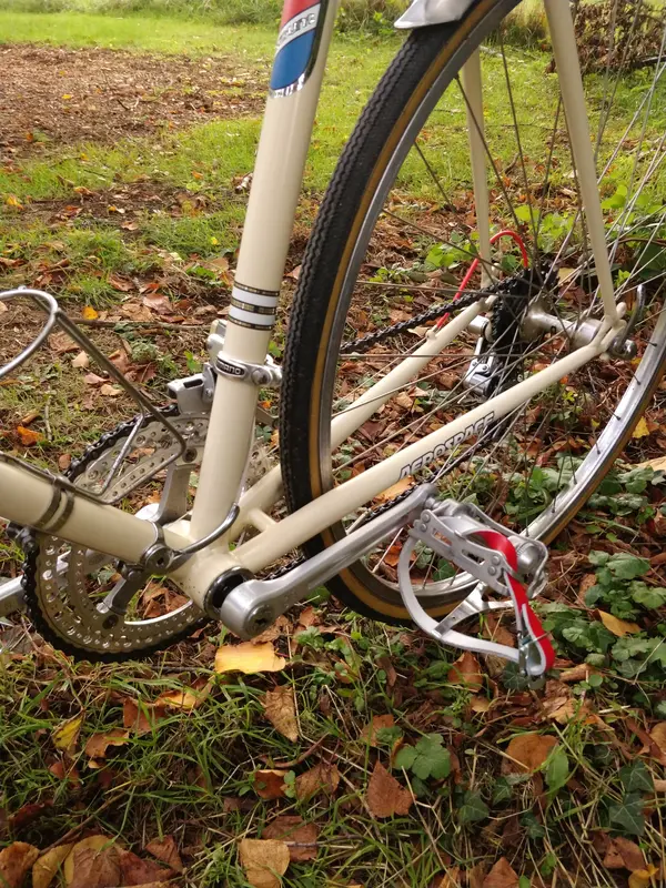

Now all parts are finally done I just need to check the rear derailleur is setup correctly as it seems to sit miles off the block and makes for quite slow shifts.

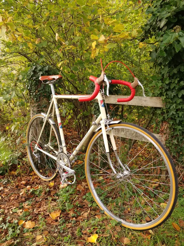

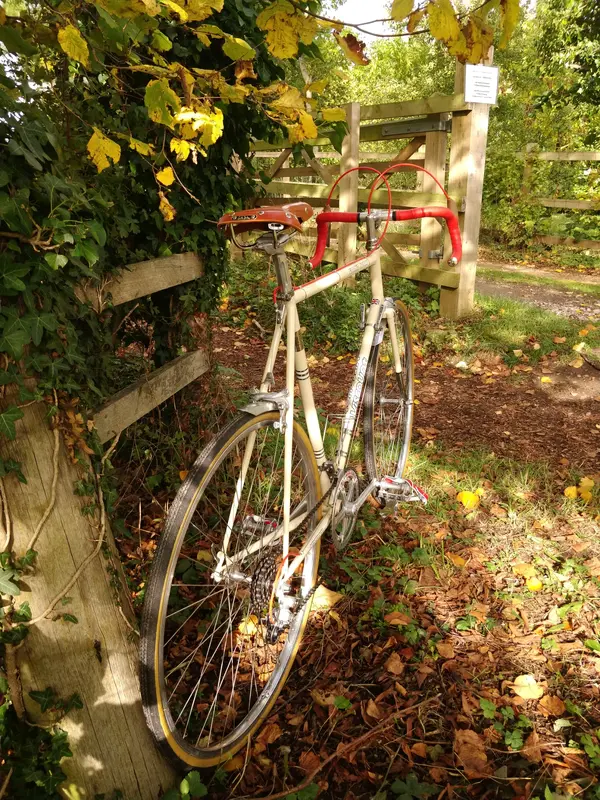

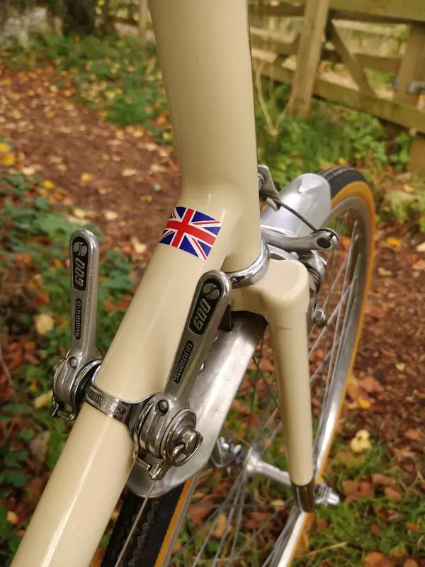

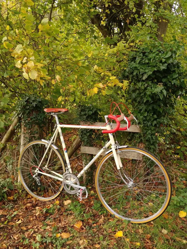

Ok, all done and some half decent photos taken - enjoy.

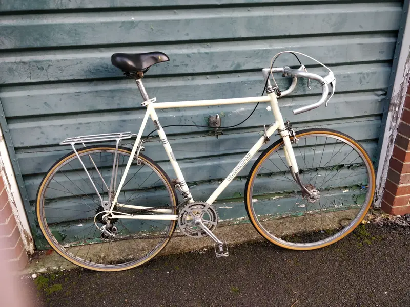

Here it is as recieved last winter!
and now!

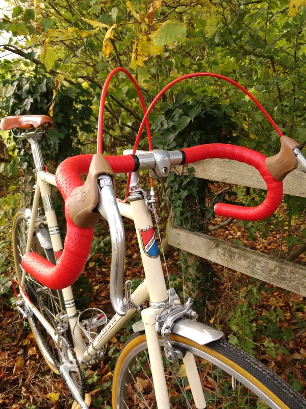

The spec:
Frame & Fork: Viscount Aerospace (1978/79)
Headset: Generic/unbranded
Stem: SR
Handlebar: SR Road Champion
Griptape: Velox
Brakes: Shimano Tourney centrepulls
Cables: Clarks
Brake Levers: Weinmann w/ Dia-Compe hoods
Shifters: Shimano LB-600
Front Derailleur: Shimano FD-6100
Rear Derailleur: Shimano RD-6100
Freehwheel: Shimano 5 speed
Chain: Wippermann 5 speed
Cranks: SR Apex-5LA SL
Bottom Bracket: M Wave threadless 122.5mm
Pedals: Campagnolo Gran Sport w/ Christophe straps and MKS clips
Hub Skewers: Shimano
Rims: Milremo
Hubs: Shimano
Tyres: Cheng Shin 27 x 1&1/4"
Saddle: Selle Italia Mitica honey
Seatpost: SR Laprade
Cable clips: Dura-Ace
I hope you all enjoyed the journey with me! Its a bit of a Trigger's broom rebuild to be honest, with the original parts being the frame & fork, the headset, rear derailleur, front brake, brake levers, freewheel and tyres. Everything else has been replaced. Thanks to the various forum members who helped me out with parts over the months!
