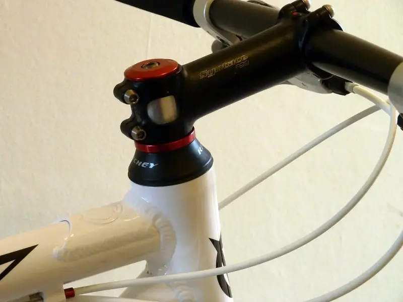

Next minor addition - a Ritchey conical headset spacer. Not used one before but very glad I thought of it - for the £2.20 it cost if does an amazing job for the aesthetics of the front end. And only 11g for 15mm of spacer!

Headset spacers: Ritchey conical spacer 15mm (11g), red alloy 5mm spacer (5g)
Stem cap & bolt: Kronos CNC alu stem cap in red (9g), Ti bolt (4g)
