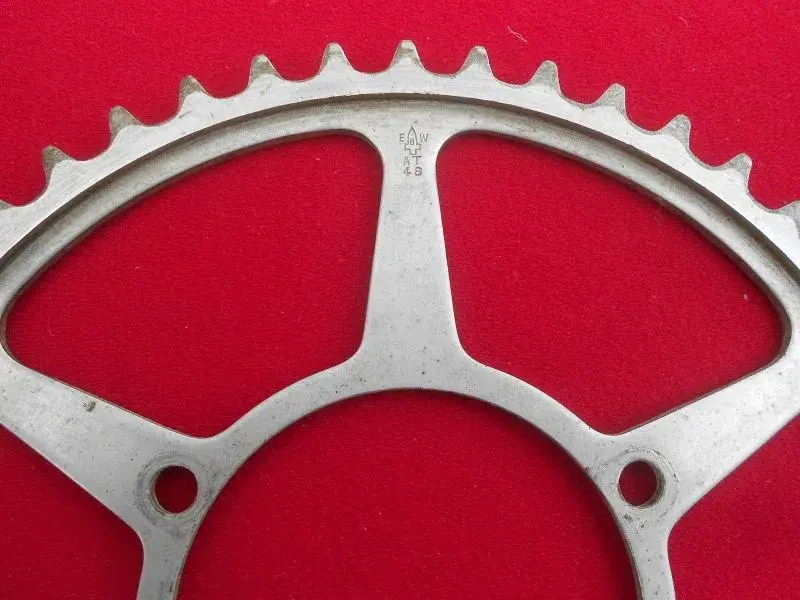

If the hubs too rusty then there should be a date number on the Williams chainring. Can help date it but could have been changed at some point in its life. The fork crown detail I've seen and can't remember. Lugs look like Ekla but can't find exactly. Tops of the seat stays unusual. Is it lightweight?

There should be some letters above the 44 and under the Williams logo on the chainring. Will be quite small. On the top of the seat tube on the right is there anything, a number or letter under a tonne of paint?

That's what your looking for with the Williams chainring if you can see it? A T on this one is a 1954 one. I see its got a chain hanger on the right rear seat stay. Detail on the rear dropouts where the seat stays join is a clue.
