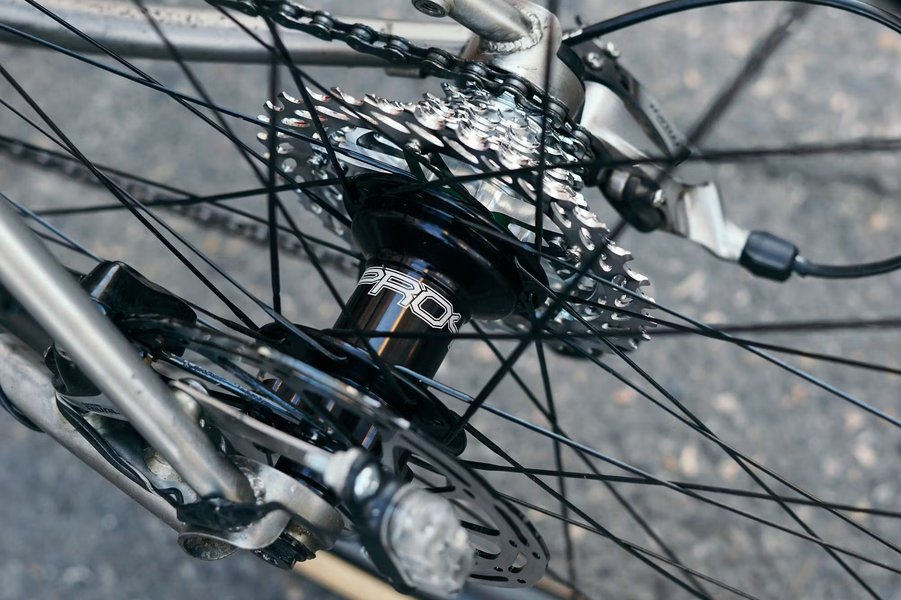

The transmission is the Rival 22 model from SRAM, only the crankset was selected at Praxis with the Zayante and its 48x32 chainrings in order to obtain a ratio of 1 using an 11x32 cassette. The objective was for us to test the Praxis crankset which turns out to be a very good alternative to the 50x34 or 52x36 offered by Sram.
For the wheels, Matthieu uses two pairs :

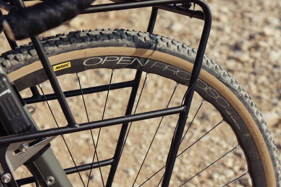

The first is intended for road and long distance adventure, it is a pair of 700c wheels radiated by hand in our workshop. The assembly is carried out on Mavic Open pro UST Disc aluminum rims. Matthieu needed to be able to be electrically autonomous on his journeys: we therefore tried the Shutter Precision dynamo front hub. This wheelset is fitted with René Herse Barlow pass (700x38c) tires mounted in tubeless. The second pair of wheels is intended for off-road adventure with a 650B pair from 2-11 Cycles. On this pair, we can find the René Herse Pumpkin Ridge tires (650Bx42), also mounted in tubeless. The rear hub is coming from Hope.
The fork comes from Columbus with the Futura Gravel carbon model. It accepts a 700x40c tire fitment as well as the possibility of using mudguards.
We wanted to try to add inserts on the side part on this fork. Our desire was to be able to offer different loading configurations on a carbon fork. At that time, few carbon forks with this load module ability option existed on the market. The result was not up to our expectations, so we decided to make a steel fork with these options. The steel fork is a fitting model we manufactured with reinforced Reynolds legs allowing the use of disc braking. We noticed a lack of rigidity on the stainless steel sleeves used during the Concours de Machines 2016. This new fork was manufactured using the so-called crank eyelet configuration to allow the use of all the loading systems that seems useful to us for a modern and modular hiker: the front rack, the side panniers and the Many Thing Cage. This fork was then declined and adapted at Victoire in order to meet each of your expectations and consider all the options.

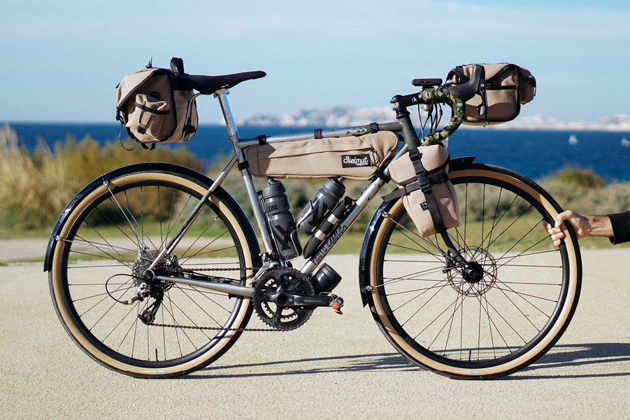

Gaby is the Victoire that is dedicated to long distance rides possessed by our ambassador Matthieu Lifschitz, the man behind Manivelle and the artistic direction of 200 magazine. Gaby is also the evolution of Woody, prototype that has been showcased at the Concours de Machines 2017 and used by Matthieu on his two first TCR races.
https://manivelle.cc/
Woody was born almost by accident, halfway between respecting the rules of the Competition and the desire to carry out our brand project of frames in standard sizes (which has since become Distance, our second brand of steel bikes in standard sizes. made in France). Despite this complex gestation, Woody had shown himself quite capable of riding long and far. After two years of intense service, Matthieu decided to give Woody a pre-retirement by transforming him into a mountain bivouac bike.
We then started from scratch, with the main objective of adding sportiness and liveliness to a formula that had proven its effectiveness.
The position was kept as it was, as it had already been validated by some 20,000 km previously covered. In order to save weight, it was decided to adopt a carbon fork. Curve was in 2019 one of the few brands to offer a fork with dimensions close to a road / gravel fork with eyelets. After a few thousand kilometers, it has perfectly proven its reliability.
All tubes come from Italy and are supplied by Columbus, with a front triangle in Columbus Life and a rear triangle in Columbus Zona. This choice brings a good balance between resistance and lightness. Small subtlety, the top tube adopts a flat octagonal profile, so as to ensure a stable support for the saddlebags attached above and below.
The bottom bracket is T47 standard. (I'd rather BSA, but hey modern and French GIGFY) Usually used on our sportiest bikes, we wanted to test its interest on an endurance bike. The chainstays and shrouds allow the assembly of very large sections, up to 700c * 45mm, offering versatility to Crank depending on the tests and tracks on which it aligns.
The group chosen is the Sram Force 1: Matthieu having largely tested the American manufacturer during the two previous Transcontinentals, he decided to keep the same benchmarks while switching to single chainring, for easier adjustment and increased maintenance.
Light, an extremely important safety element (especially in long distance races where Matthew is frequently required to ride at night), is entrusted to Sinewave for the front and to SON for the rear. After a lot of testing, we decided to fix the light high up and prominently, just between the tire and the saddlebag. Screwed directly onto supports brazed to the frame, it is both perfectly visible and protected from shocks. The wire is also integrated inside the tubes to protect it.
The running gear is 100% European, with a SON (Germany) dynamo hub at the front, a rear hub and Mavic circles (French brand located in Annecy ), and finally Sapim CX-ray spokes (Belgian brand). Shown in the workshop, they bring dynamism and flawless reliability to the bike.
Luggage storage is inseparable from an endurance bike. It should allow you to carry everything you need for sleeping, eating and repairing your bike while remaining relatively minimalist. We once again called on Rodolphe from Helmut Equipement for the design and production of light, ultra-resistant, waterproof, modular and perfectly integrated elements into the bike. The frame bag, usually attached by means of scratchs (Straps?) is here screwed directly to the frame in the brazed stainless steel inserts. In addition to protecting the paint from abrasions, the integration is complete. The rest of the luggage is derived from the Helmut range. Rodolphe constantly evolves it following the feedback from Matthieu, so as to offer an ever more successful and efficient ensemble.
With the frame supporting two saddlebags and the seat post another, only two small racks attached to the fork are used for the rest, allowing a significant weight gain. Going from Woody to Gaby, three kilos were gained. Gaby weighs as well, fully equipped without saddlebags, 9.1kg. The luggage set adds barely a kilogram, so Matthieu can benefit from a fully equipped long-distance bike for the weight of a light gravel bike.
The weight gain, but also the reliability guided many choices. All peripherals come from the American supplier Thomson. Indestructible, they are also very light. Matthieu particularly fond of the khaki color (Woody was already painted in this color), we selected the “jungle” limited series to echo the color of the frame and the saddlebags. Once is not customary, the saddle clamp is added in aluminum.
