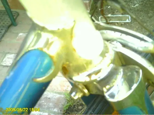

More Dunelt 10 speed info just discovered. Hope I am not boring anyone to death. I noticed that the bottom bracket sleeve (on my bike and on the eBay frame) has an oval within it stamped RGF. Here is a cut and paste of another post I discovered explaining it.
