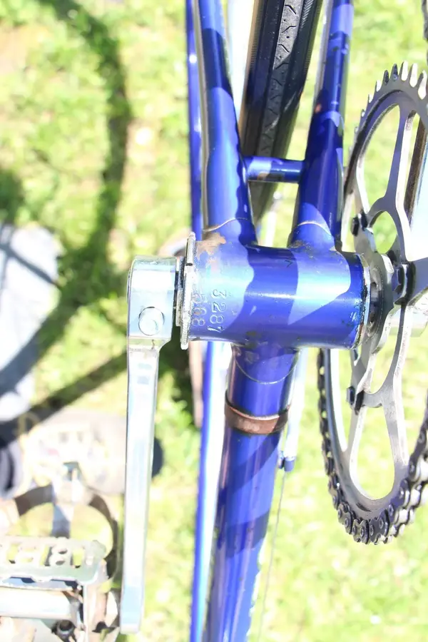

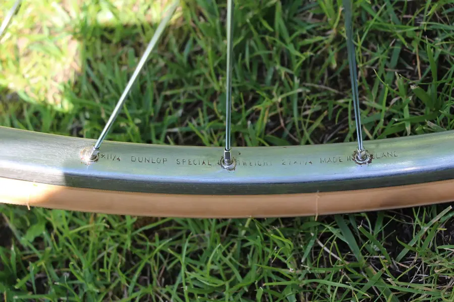

My dad passed with CV19 in Dec last year and left me his pride and joy of which I have attached some pictures. I have had Northwood Cycles refurbish the running gear and give it a very decent (but sympathetic) clean up. Now I need help to identify it please. There are some hints below in the pictures and I have the frame number which matches the one on the fork tube.
Serial no. either 568 3287 or 3287 568
If its a 1956 model this would be about right from what I know but if not, would be great to know what year and if possible what model (that swhat I am realy after)

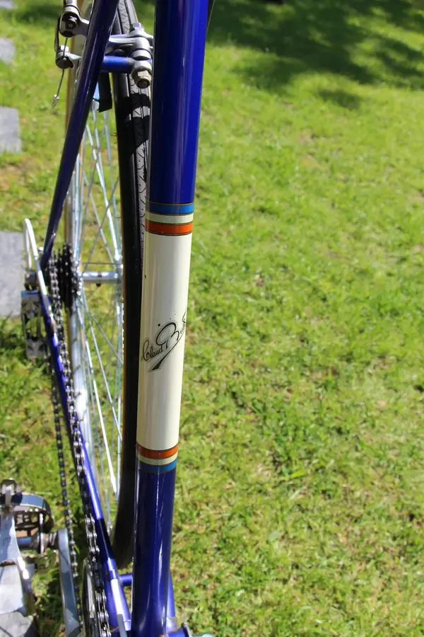

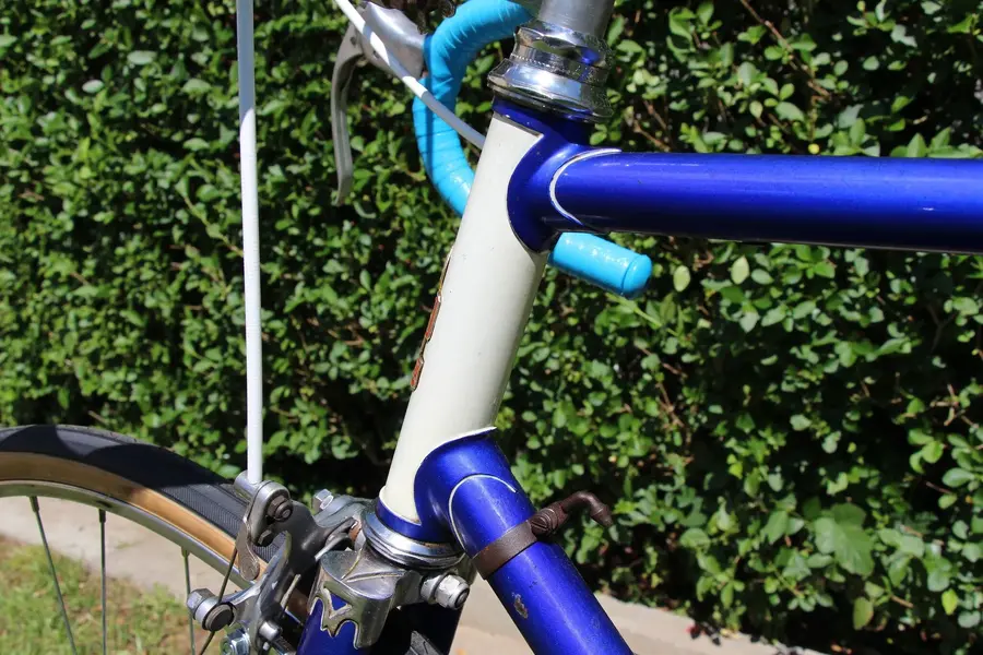

The pictures dont really do it justice - thew paint is still in remarable condtion considering how old it is and how regularly it was ridden in the early days (but not at all int he last 40). It's almost all original and was owned by dad from new. The paintwork is untouched. The only changes that are from the original is the work done by Northwood which includes polishing up the original rims and respoking them as well as all the running gear stripped and bearings replaced etc. New tape on the bars, new cables, brake blocks and the original tyres had to go but that's it.

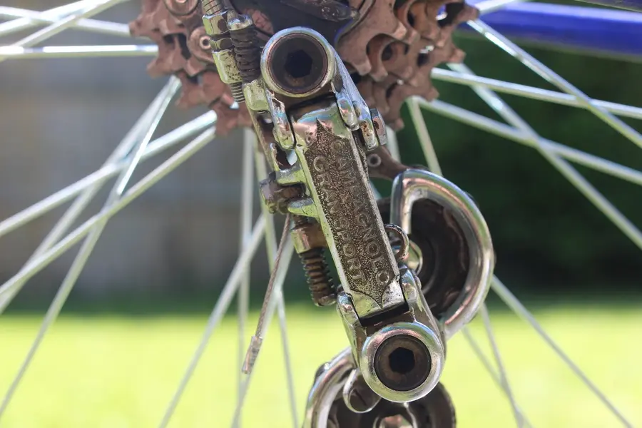

5 speed with Campag Gran Sport deraileur

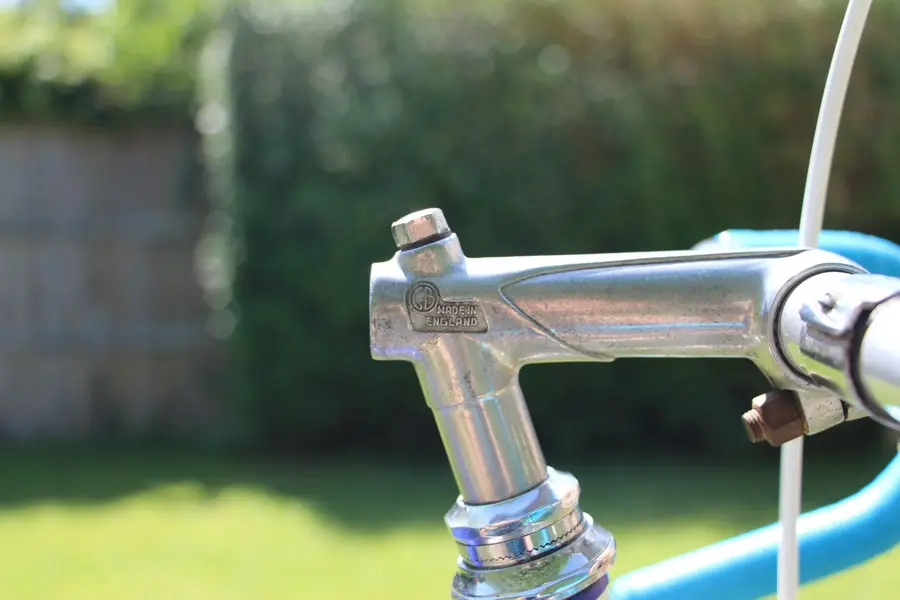

GB Coureur brakes, handlebar stem and levers

Dunlop 27x1/4 special lightweight rims

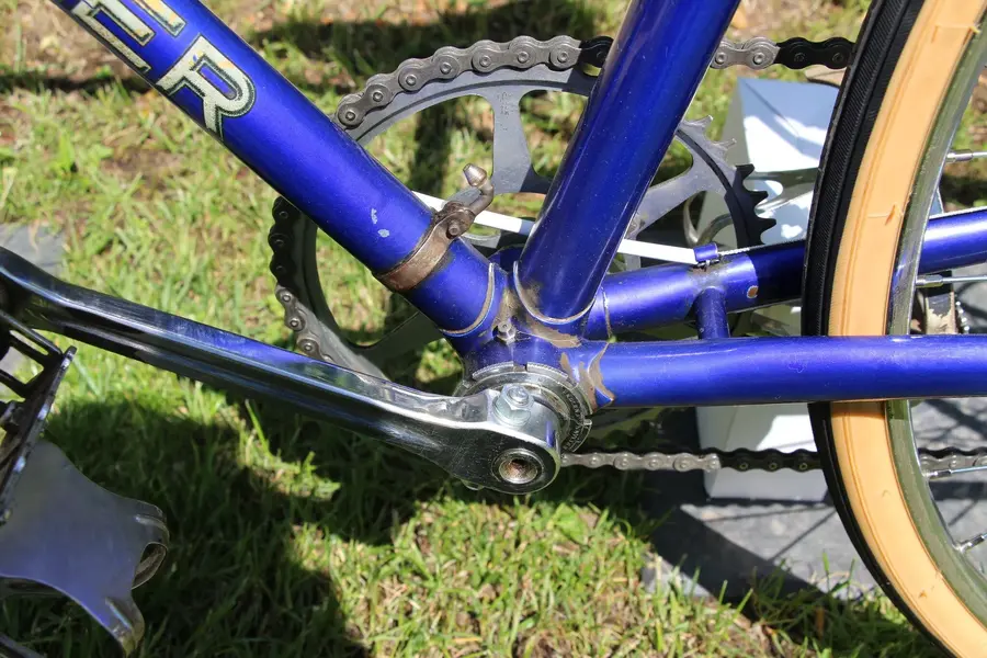

Steel cranks with the word Williams on them
There is a grease nipple on top of the bottom bracket

Definitely late 1956. I’ll get back to you with more details later (I’m away from my laptop)
Gut feeling is it’s a Tour of Britain, but the forks are most definitely Holdsworthy not original Claud, whereas the frame is.
It might be one of the frames “received” by Holdsworth when Claud went bust late ‘56
Ok, had a closer look on a large HD screen.
Definitely August 1958, Frame is also definitely a Tour of Britain model.
This would have been double butted and was the top of the range.
Front forks definitely Holdsworthy circa 1958-1962.
Paint job and decals are a bit of an oddity as the 531 is wrong and pre-dates the frame, so do the down tube "Claud Butler", these are pre 1948. and none of the "Claud" Clauds or "Holdsworthy" Clauds ever had the Claud signature placed in the middle of the seat tube. This suggests a shop re-spray, still early, perhaps late 50's or early 60's using whatever transfers they had in stock.

The frame stamp is absolutely in line with an August 1956 Claud Butler frame build. And I’d put money on it being a Tour of Britain having owned one.
And there’s no way on earth that Dolan would have made an exact replica Holdsworth fork. Even if he wanted to I doubt very much if Claud would have let him.
It’s true origins I would say are exactly as I’ve already explained. The frame was made by Claud the fork by Holdsworthy.
How or why they came together and why the odd graphics, I agree it’s unlikely will ever be known.
