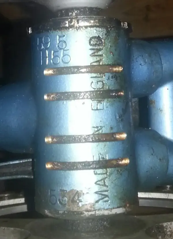

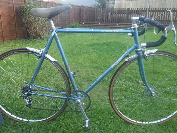

Here are some pics of Lee Langford's very early TI Raleigh 753 - SB534.
This bike appears to my (non-expert :) ) eyes to be entirely original - apart from the possible addition of the mudguards. I think that it is early 1976. It appears to have all-original decals, including one from EG Bates - presumably, the retailer ?
I've done some looking around on Google and I see that Peter Kohler's time trial machine is :
BB stampings: SB576 59.5 H31
Lee's machine is : SB543 59.5 H55
What I can't understand, is how is it that Lee's bike has a lower SB number, but a higher H number ? Is it earlier or later than Peter's ?
Like Peter Kohler's machine, this has a single chainring, so I assume that it is a pure time trial bike.
All fittings appear to be Campagnolo,
Lee is considering selling this bike, but would like to know an approximate valuation - any ideas on this ?

SB534 is end of 1975 most likely. The EG bates sticker is typical of a frame ordered through EG bates who were an authorised dealer, ordered for a customer and not stock as per the "H" stamp, not always sure what the number after the stamp meant. Maybe each dealer was allocated a block of order numbers. size 59.5cm.
Angles look typical Road / Kermesse with bottle brazings. TT would have had vertical drilled dropouts and no bottle brazings. Lack of top tube cable eyes was trendy LOL

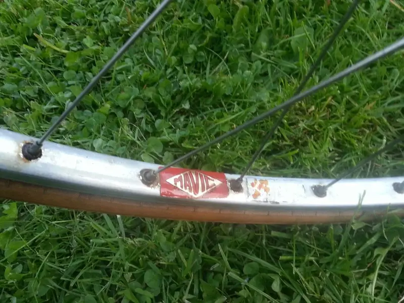

Are those rims Mavic Module E? not clear. The dent in the chainstay would be to accomodate multiple chainrings....
God knows who put the seat pilar on back to front............... !!!!!!!!!!!!
Looks like a genuine frame with a bit of swaps over the years.
Price depends on who wants to buy it.
Shaun
Hi Shaun,
Thanks for taking the trouble to post some very useful information.
This is the oldest 753 SBDU frame that I've ever heard of . . . . . . . I wish it was mine :(.
Been thinking about this today :) I wanted a 753 frame for my 16th Birthday which was December 1975 (fat chance) but I don't think they had been released to the public in 1975.
Being a Raleigh Dealer we had seen them with the reps but I don't think 753 came out until 1976, that means it's probably one of the first 753 frames released to the public. Unless my memory is playing up again...............
Still can't believe the seat post is back to front :(
Shaun

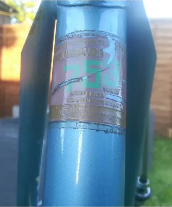

Difficult to see...........are the lugs cut down Capella?
