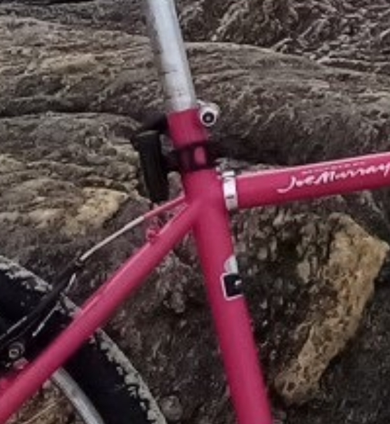

Some people drill the collar out and run the cable through it or put a cable stop in it. You can also buy clamp on stops for the cable. Personally I have always just ran full length outers and removed the clamp, works fine but you need to zip tie the cable on.

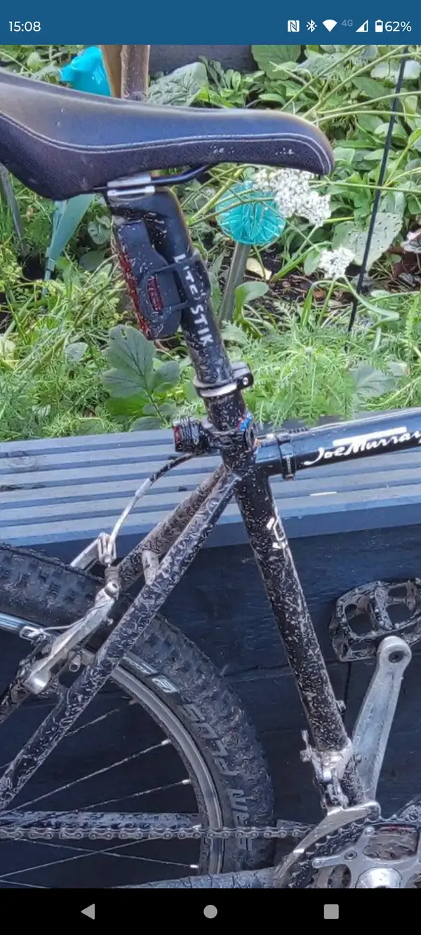

You can get clamp on cable stops, single or double stop, I used something similar to run a v-brake on a '91 Hahanna.
There are various makes available eg...

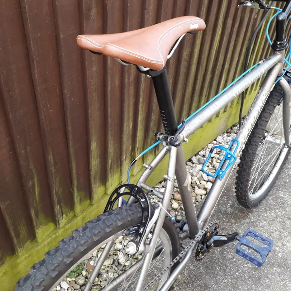

thats similar to my 1995 rockhopper.
i had a tube around the seat post so i just used full length cables and secured to the top tube with a small clamp i got off aliexpress.
