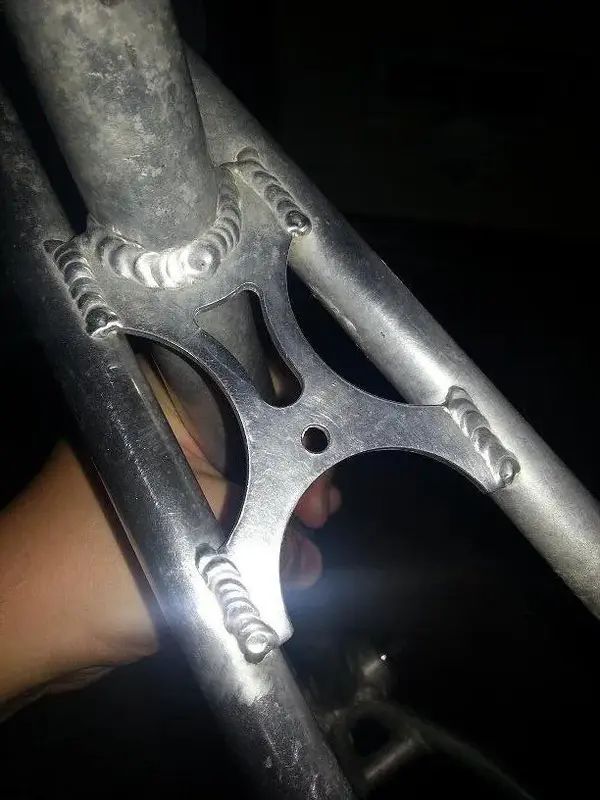

Yes if you have a pivot bolt hole at the top of the forks as shown in the picture. The pivot must be attached to the fork crown or sus forks brake bridge. The system is primarily an alternative system to a canti hanger cable stop :wink:
Its to go on the rear brakes. The forks are undecided at the moment. But I have a hole drilled in the brace.
