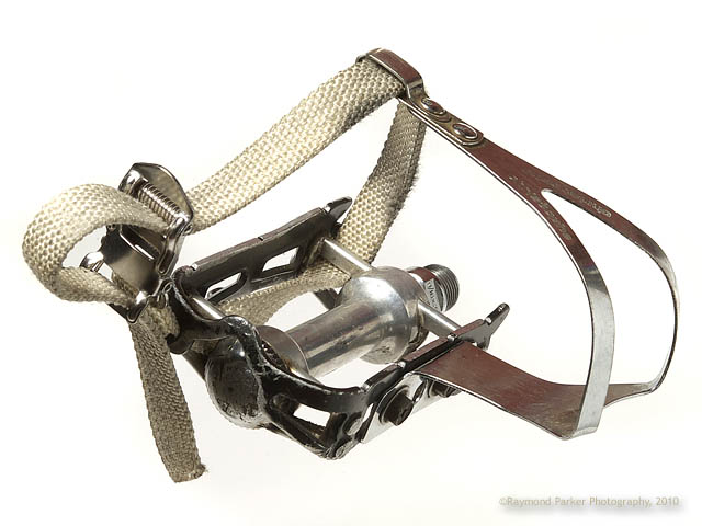

Edit: strap hangs out the clip, so you pull up on the strap to tighten. I prefer leather straps (matron). Bend metal toeclips to fit the front of your shoe. You'll find some pedals are easier to flick over than others - quills aren't the easiest. I find it nice to use a pedal with a flat bottom when riding fixed because it gives you something stable to stand on when you push off, then flick the pedal over and slip your foot in on the second revolution. Just takes a bit of practice with fixed gear!
Exactly the opposite to what jonny69 posted.
Must be a nightmare to do on the road, pulling down to tighten.
Jet lagged and no images loading in the airport. Indeed, pull UP on the straps to tighten and the straps go the way round as in that pic ^ above. SO TIRED AND CONFUSED!
