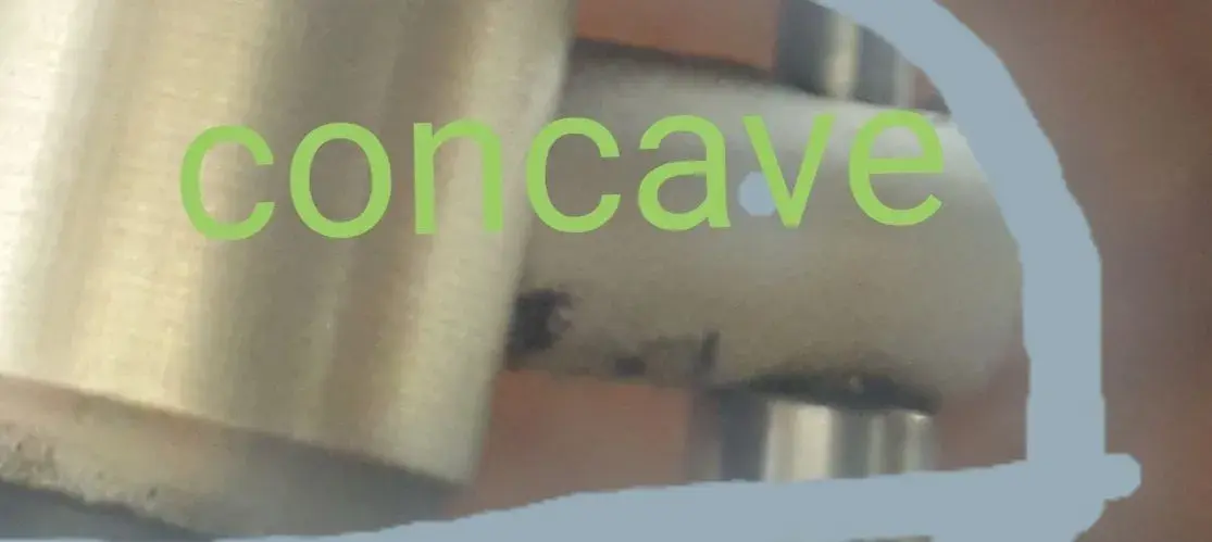

I’ve got an old USE seat post and on fitting a (charge spoon) saddle I find the centre area of the rear top clamp bar hits the back edge of the cup before it’s clamped the saddle rails down.. It’s like the shaft that goes through the post is a couple of mm too short?!

I had exactly the same issue with the same saddle. Fortunately for me the top clamps were different. One had a longer threaded area than the other. I swapped them round and it was fine. The bar that goes through the post could do with being slightly longer though and I believe they do different sizes.

I can't speak for the op but on mine the bar the bolts go through is much shorter. In fact the bolt heads almost touch the post. Whilst your front clamp has the central part that comes down towards the bolt one of mine is almost flat..
That is, I believe, the only reason I managed to fit a charge spoon saddle.
I hope it makes sense as I'm a bit pony at uploading pics, as I believe a pic may make my explanation a bit clearer.

Your bar looks upside down... Has it got flats where the bolts go through? I know it sounds daft, but try the bar the other way around.

I think the last owner must also have had the same issue - I see the bottom of one of the top clamps has been ground away(!) I hadn’t previously noticed but now I’ve re-arranged it fits.. I’ll upload some photos shortly..
I’m familiar with the clamping arrangement of USE posts as I’ve had them before, always with a Flyte saddle but not sure it’d make a difference. The rod through the post is definitely shorter than the one in the photo above ^^

Has the bottom of the clamp been visibly ground away as one of mine appears to have come like that. I wonder whether there were different parts for different fitments as my post for the bolts is also shorter than above.
That's how it is both ways. This gives a float, or adjustment flexibility.
See a gap between bolt head and rod?
Baj. Some assemblies out there are repro, as oem got lost, broken, accidentally swallowed etc...
The bar is just alu rod with 2 holes drilled in.

Are they the 'SX' longer bar, with oval slits, the (original) bolts where also profiled to sit into that slit a bit (bolts slightly domed under the head).
The older USE posts had shorter bars, and recessed bolt head holes.
Hey Matty, yes, I’ve just added photos of mine, its definitely been machined so it’s shorter. The top bar overlaps the cup, I reckon it just needs a longer rod(!)
By the way, I’ve just bought a longer rod and bolts from WD Pro on that link above.. if anyone else is struggling give him a shout - good bloke
