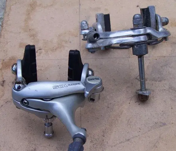

I am attempting the same upgrade, shifting my old 105 (BR-1055) (7 speed) groupset from my now, trashed dawes to a cheapy temp frame. The removed single pivot brakes are - Weinmann 500s. But the brake stay tubing will not accomodate the length of bolt required to grip the 105 fixing bolt, which is a lot shorter than the Weinmanns. Plus the later frame's (the dawes) brake stays allow the allen key fixing for the 105 caliper to seat properly.
Below is a pic which may better explain.
Im a bit stuck now but hopefully this will prevent you collecting unnecessary parts should your frame be unsuitable.
If you want a pic of the two different brake stay tubes let me know.
If anyone has any fixes to allow this retrofit, yes please, as I'm still without a bike.
Good luck TD

Yes.. i'd love to see a pic. How do i know if they are steel or alloy rims?
EDIT: Sorry.. only saw the pic once i'd logged in. They do look the same brakes as mine

the dual pivot in the photo is for the rear stay. the front one is much longer
