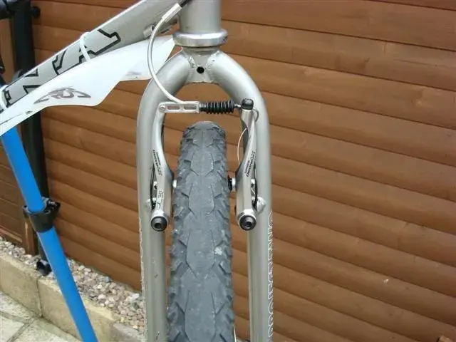

Spent all day trying to fix a creaky handle bar on the Kilauea SS today only to discover it was the stem quill that needed cleaning and greasing! Sorted that and now the b****y brakes are making the bike sound like a Raleigh shopper every time I go over anything other than smooth tarmac. Turns out the linkages on the M739 V brakes are so worn that there is a huge amount of play in the blocks resulting in a not so musical racket :evil:.
I thought SS's were supposed to be quiet! Looks like I am going to have to visit the LBS tomorrow for some new V's :cry:

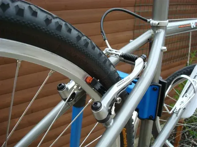

Managed to sort the noisy M739 V brakes, changed them for a new pair of LX V's (no linkages). Much quieter! Got the LX's from the Woolly Hat Shop, excellent value.
Trevor.
