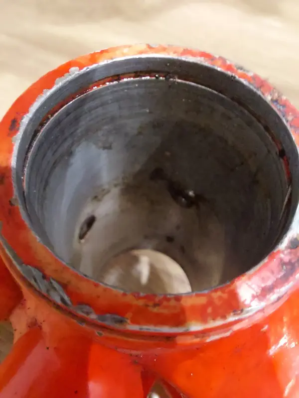

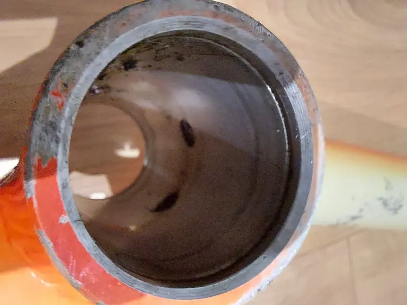

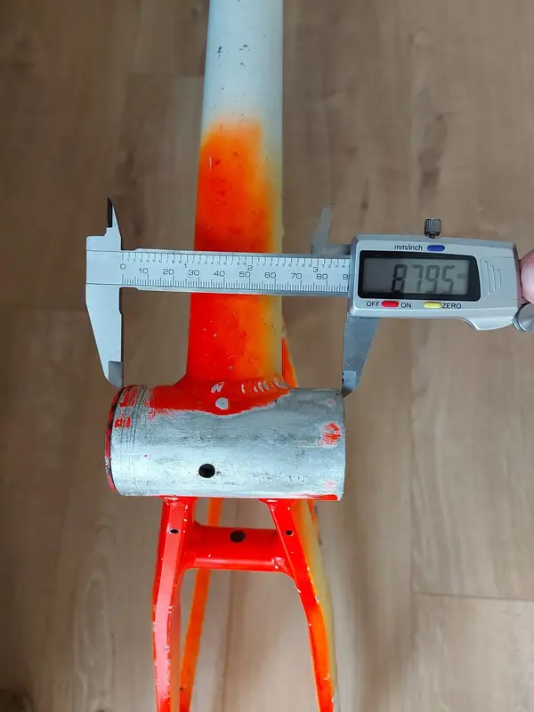

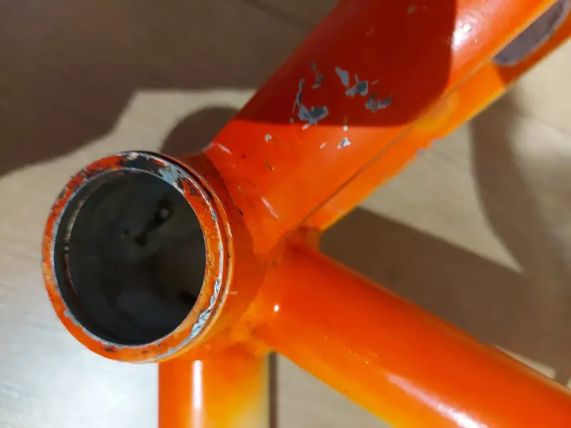

The shell width is 88mm
The shell is threadless with a groove on one side...could this be for a circlip of some sort?
So, looking at what I could purchase as a suitable bottom bracket...I've drawn a blank🤔😩
Something like a frame saver or threadless bottom bracket would be the ideal solution....the axle widths and square tapers are ideal for period XT or XC Pro cranks I plan to use.
The problem is....they are all 68mm shell widths.🙄
Any one know of any bottom brackets that would suit the 88mm shell width?
