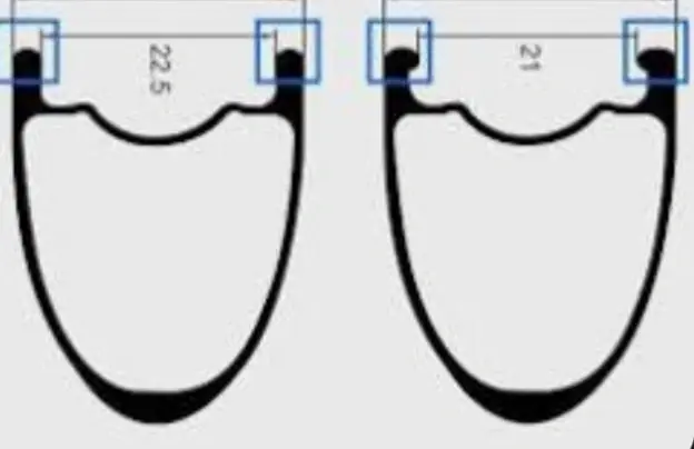

Tyre popping off the rim question here
Happened twice now
First time I thought it was the cheapo tyre, so binned that and changed to Schwalbe ones, new tube, new rim tape
Happened again, tube and tyre seem fine
No apparent distortion to the rim wall, clincher edge seems uniform around the inner wall
Rims are Weinmann 27x1 1/4, probably 1970’s-era, tyres at a modest 55/60psi
Have been tipped the max pressure might only be 45psi as maybe they not ‘high pressure’ rims?
Any thoughts welcome
