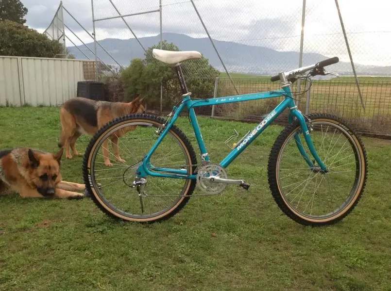

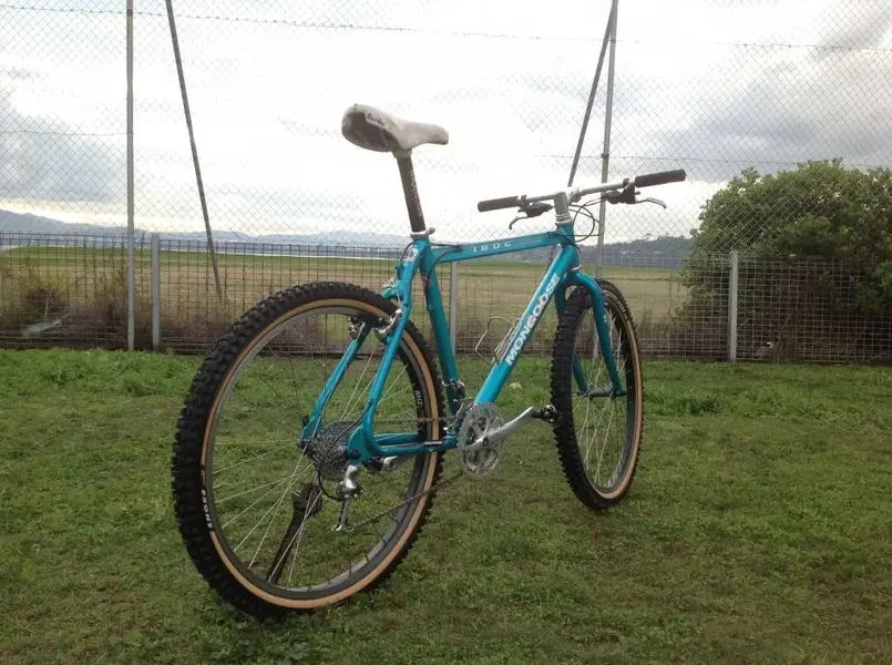

Turquoise, Loopstays... 1992 Mongoose IBOC Team
When I owned one of these back in the day I had Manitou 1s. If I can get a good clean set of those then it will have a suspension fork again.
Hi Love the Goose, but please answer this
I know pictures can be disceptive but can those two dogs "Really" jump high enough to warrent a fence akin to one found as Stalag Luft 3 :D
B.T.W great use of an adjustable spanner :cool:

Haha, their jumping abilities are limited to about chest height fortunately... Our yard backs onto an army base sports pitch so the big fences are to keep footballs, cricket balls etc on their side, although I've been here a month now and I'm yet to see anyone out there.
One day I'll take proper photos with something better than an old iPad and I'll find a better prop when the time comes, but the old 12" shifter did the job for these, haha.
