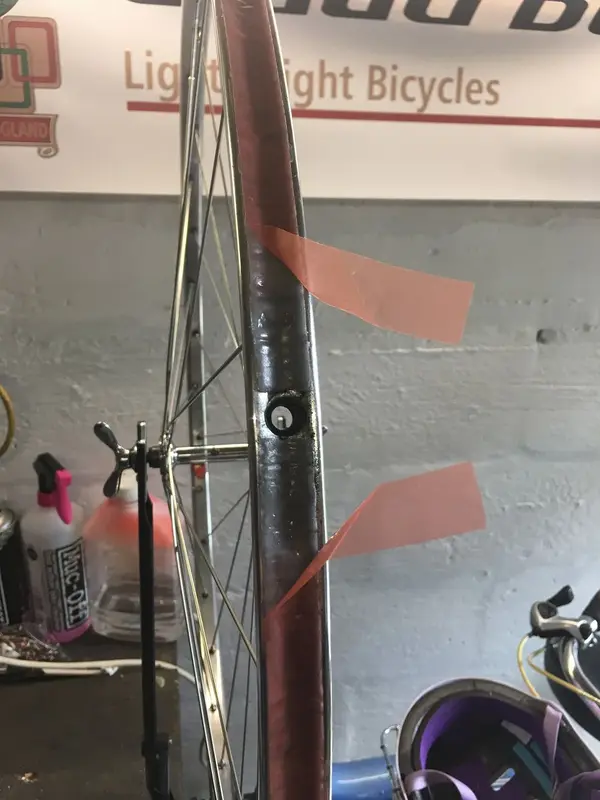

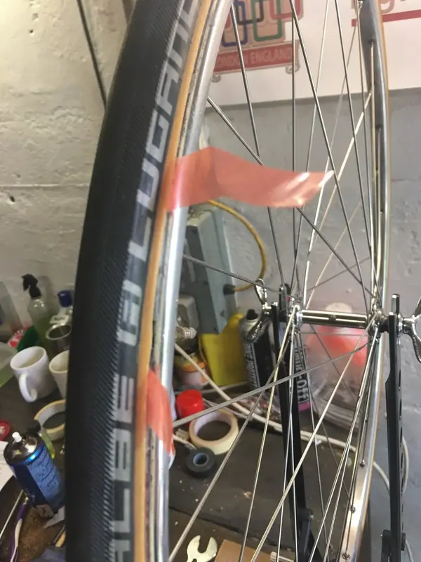

Gentlemen, your advice and the Effetto mariposa worked a treat….
These are going on to my ‘54 Jubilee Special she should just be ready for this months 40's & 50's themed RBotM.

Leave them pumped up to max pressure for as long as possible before riding - it really compresses the tape and closes all the edges, the tape almost kind of beds down and it changes to look like a bead of glue around the edge rather than a strip of tape :D
WD :D
WD :D
Will do.... they are on the bike now, brake cables run, just got to sort the 4 speed Sturmey gear cable.. another first for me, so I’m off to do some reading up.
Thanks again for the advice. 8)
The Effetto Mariposa Tape works great for getting a Tyre on. It's when you have to "Nuke" it off that's the problem. I used tape for awhile but have gone back to glue for that very reason.
