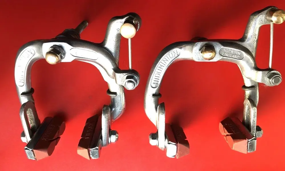

It seems like you may have made the decision to go to 27" wheels, but have you thought of trying to find vintage brake calipers that have a longer reach? I have a source for N.O.S. Bluemels mudguards, too, if you need that.
I would love the source for NOS Bluemels mudguards please. On the wheels I would actually prefer to go smaller than larger as it is closer to the original size (a 650B rim is half an inch smaller while a 27 inch is over an inch and a quarter larger) but I have been constrained by the brakes which I want to keep reasonably original (certainly 1950s and preferable Raleigh, GB Coureur or Weinmann). I will happily check out vintage long-reach brakes.
On my Model 26 RRAs, the early GB "Hiduminium" brakes will accomodate 27 x 1 1/4, 26 x 1 1/4 & 26 x 1 3/8 wheelsets.
I don't know if your Lenton has similar geometry to the RRA though, but the pad adjustment slots on these brakes are very long.
I am looking at a set on eBay now - 38mm adjustment in drop! That will certainly do the trick
