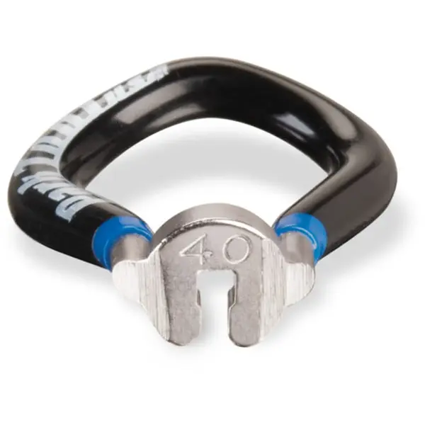

I got a special "four sided" park spoke wrench, it has a bit of extra material to grab onto each spoke:
