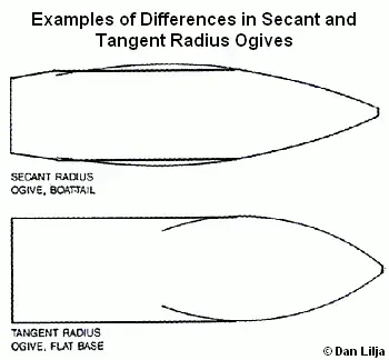

You can't really use a parabola given how you're constructing the cabinet so far. the parabola doesn't meet tangentially to your central cylinder. Given that you're unlikely to be able to make it meet to a perfect end and hence blunt nose as in the Parabola, your best solution is to use a Tangent Ogive. What's the minimum width you think you can safely cut the slats to? I can see one solution where all the slats taper down the same, but this really limits the length of your arc.
I was looking at 40mm though maybe 30-35mm at a push. This i think depends on the bending that the ends will have to undergo before any shaping to them occurs :?
