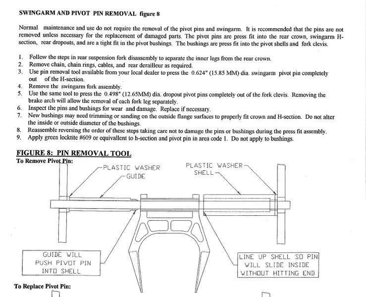

Can anyone take this bolt off of their Manitou and photograph it individually?
The black bolt isn't a bolt its just an expanding plastic clip that retains a metal bracket that holds the rear shifter cable in place as it makes it way to the rear mech by making use of the hollow bushings
not the best picture below I know but might help
also worth looking at is this link to the service guide, albeit its for M3's but the pivot bushings look almost the same.
http://www.retrobike.co.uk/gallery2/v/M ... k.pdf.html

Thank you! That solves the "mystery" and it looks like the bike is exactly how it should be. Travis was using the zip tie you can see in the photos to take place of that "bolt" to act as a cable guide for the rear derailleur.
