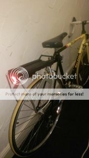

Hi phoog has posted a pic of his Racer with a seat post rack and panniers on and i already have one and will try it latter on , but i do thank you for your advice ,very best wishes Brian.
Hi well i managed to fit it but putting it on the seat post made the seat to high ,so i have put it on the upright post which seems to be ok ,and if i make two brackets it should be secure. sorry about the poor qaulity pics
Get some Axiom eyelets (https://www.sjscycles.co.uk/mudguards/a ... -set-of-4/) and the load is applied directly to hubs instead of the frame although I wouldn't sweat it too much.
I'm sure the loads from a professional sprinting far exceed those from a rack being pedalled slowly uphill (taking 753 as a worst case example). I toured on a 531 race frame using p clips to mount a rear rack about 20yrs ago without much of a problem
Hey thats excellent and is just what i am looking for even though the rack is very firmly attached and better if supported at the Hubs,thank very much and best wishes Brian.
