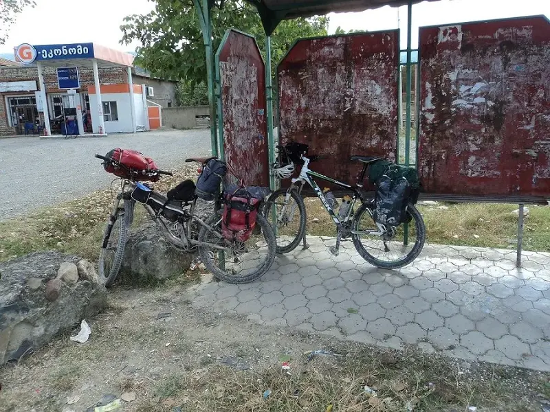

But, MTBs can take you to places that nothing else will and they're a lot of fun. In September went to Georgia (being old and retired has it’s advantages) and cycled from Tbilisi to Tusheti in the Caucasus and back, over some big passes and took the MTB. Some difficulty finding a suitable rack (eventually went with Thule, brilliant) and significant weight (best part of 30 kg with bike, racks, camping gear and food supplies) but was able to get up and down anything, albeit sometimes manhauling the bike up the steepest passes. In descent the bike, and especially the disc brakes, came into their own. Photo shows the bikes and how they were packed.
