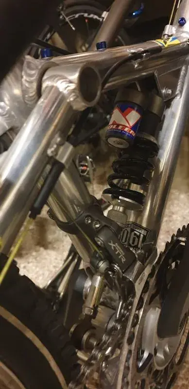

I think the problem is that whike the multi-mount mechs allow for both top and bottom pull routing, they are a bit of a compromise. A dedicated top pull mech should allow for a better cable run as it isn't trying to be one size fits all.
A few pics below of a few different top pull mechs and how they look on a few of my builds. None have the clean, straight cable run you'd want in an ideal world, but they are xtr m953, xtr m970 and xt m780.
None are as aggressive as yours looks from the pics, 2 of the 3 are retro frames with more modern than originally equipped with mechs. The m970 is probably the best of the bunch angle wise.
