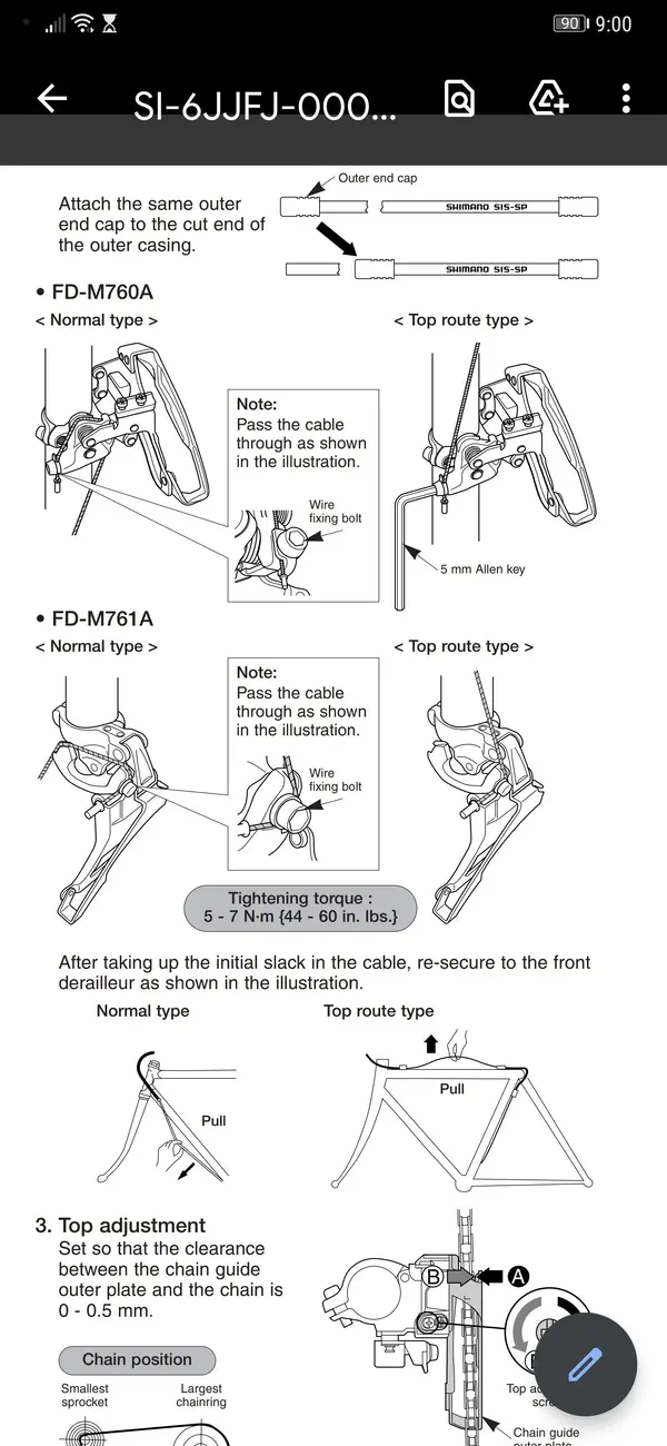

I think the cable is supposed to go around the black pivot bit rather than direct to the cable clamp.
Re: Re:
That's for bottom pull usage, in the dual-pull mechs.
The cable is supposed to go around that, pretty sure. If you think about the pull from top. The direct route in the pic is wrong.
Essentially the cable run turns a top pull into a bottom pull.
Bottom pull would run straight to the cable clamp.
As the cable is pulled up (shortened) , it pulls the mech out.
For bottom bull it loop over the top, between the hooks, so it behaves in the same way the top pull does.

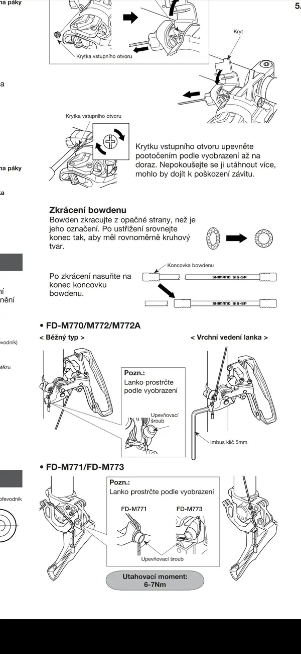

Adding some pics
