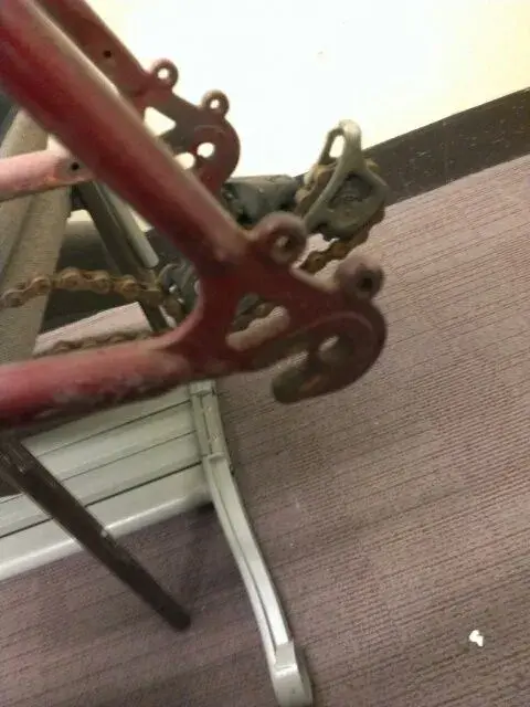

Todays find
Was looking at the drop outs and they look quite short compared to other singlespeed I have built,do you think it should work or will I need a chain tensioner?
Cheers

Nice find and recycling at its best.
With a strip down, clean up with spirits and a toothbrush that frame will come up nice I recon.

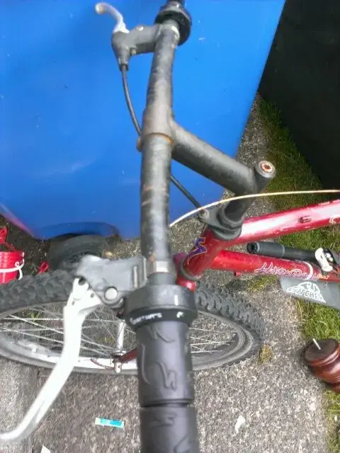

You mean white spirit? Never thought to usr that,is it safe to use on everything?
Yes we havt bloody massive hills but I have tree trunk thighs and walk the steepest ones

Thought you had some :) well I have to tip the hat as I need at least a few gears to get me up the worst even on our gentle hills here.
Yeah I've done a few strip downs and rebuilds and used white spirit to clean out gunk and grease with no real issues. I might be being uneducated about this though - I guess it could make plastic parts whiten and turn brittle but then again 20 years exposure to UV light already probably has done that
Bike shops sell muc-off, but in my experience it's crap for all but oil and mud and fresh plant sap. You'll need something aggressive to strip that aged gunk off the bar - white spirits or another solvent (meths etc) should do it. Squirt of WD40 and a wipe with a rag is usually what I do after.
A Dremel should clean up that skewer. They make a few brush attachments (one of stainless steel, one of brass) that will strip the rust off it in about 30 seconds.
Or you could soak in CLR for an hour or two.
