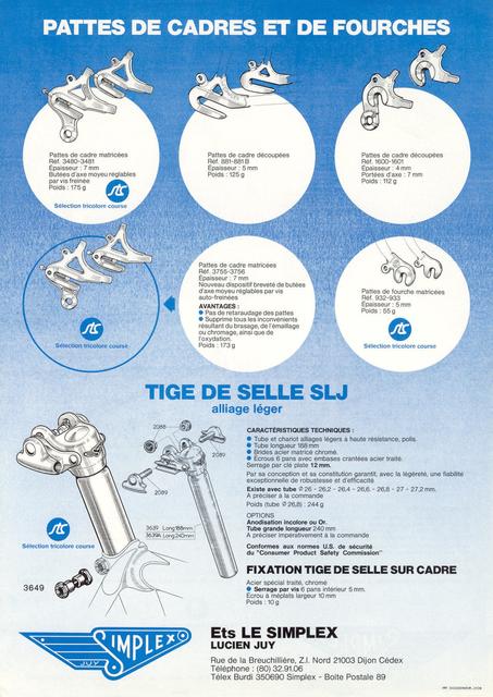

Back again.....Just to add add more info....
On the rear ends SIMPLEX JUY or it could be JUY SIMPLEX is stamped. It surprised me as I thought Simplex made the the derailleurs, etc only so why is it stamped on the frame itself?
Help!!!
Ps I mean dropouts of course....
