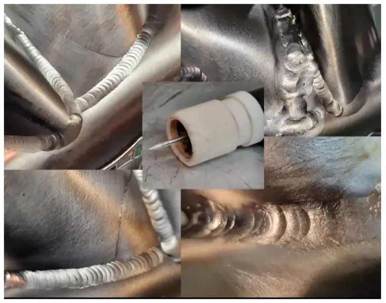

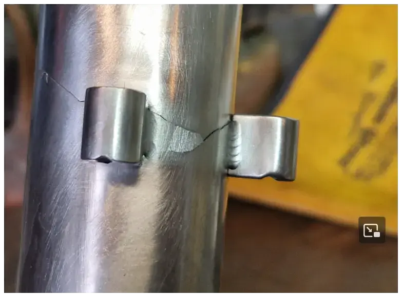

these are fixes of badly designed but nice pretty ti frames. Pretty welding is easy, but with these fixes, you have to put material back on to create the strength to prevent it failing again
Ladies, this is what your lovely little pretty welds do on a mainstream titanium frame - from an engineering perspective they are not good or strong welds or designs - so break, catastrophically fail in fatigue, have a good evening 👍

Hi :).. you can make pretty welds that don't break in the first place, but most frame builders welders / designers cant aren't pro engineers so cant tell the difference or figure out why they fail, or understand the modus operand of fatigue in Titanium and the material properties to prevent that type of crack propagation. Fixing them is tricky but focusing on making repairs pretty, tends to reduce the strength because the original designs need changing, and loads redistributed where they failed were flawed. With heat treated, al frames there are a whole raft of different heat treatment issues to overcome.
