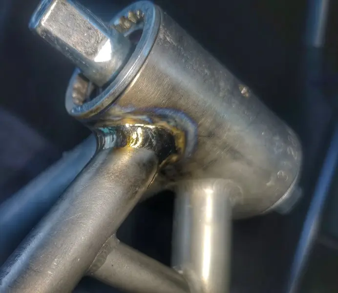

Took it to my local welder & they were completely unphased. They asked me for a sacrificial BB to protect the threads from distortion. The guy only welds ti & has worked in aerospace industry for 25 years. He suspects the previous weld had stainless steel wire in it. £30
Hopefully it will last.
Looking at pictures on the subject I'm not too concerned. The weld is bright silver except for that bit of blueing at one end & it's not as dark as picture. I think it just surface & will come out with wire wool. I also showed pics to a lad I know who was a frame builder & ti welder in the past & he never commented on the colouring.

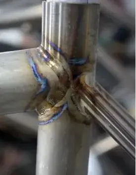

http://www.metalspiping.com/how-to-eval ... ually.html
This is an undressed weld from a high end ti frame builder.
Happy to hear from folk in the know.
The blue bits are just oxide layers that were beyond the argon shield protection area. Around 300<340°c temp range. Not an issue.
