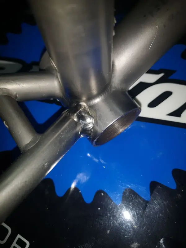

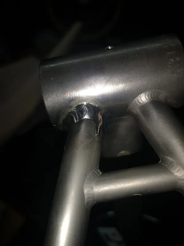

Cheers all. Aye - some of the repair prices from frame builders are well beyond me at present & this is just local & a canny bunch. I was surprised it was so cheap. I was expecting a bit more as the last repair, a split at top of seat tube was also £30 & I guess was a bit simpler. They're a big outfit I just tried because they were nearby but thought it would be a fortune. Maybe they enjoy the distraction from the big projects! http://www.impressivewelding.co.uk
mdvineng":157d1oh0 said:
The blue bits are just oxide layers that were beyond the argon shield protection area. Around 300<340°c temp range. Not an issue.
That will do for me! Thanks!
& with the lightest of rubs with 0000 steel wool the blue is gone.

As titanium is highly reactive when hot and in the presence of oxygen, a good weld in titanium requires what is known as a 'back purge'. A 'back purge' is simply a system that is setup so that some inert shielding gas flows to the back of the weld being made.
A previous repair weld on my ti frame has cracked. DS chainstay to BB. Impatient question as my local welder is closed today - can a Ti weld be repaired a 2nd time usually?
Cheers
