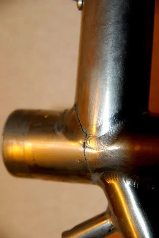

I have a Taurus XT , welded Ti frame made out of IMI Alloy ( 6%) aluminium) 1994 se pick showing fatigue failure on seat tube. I have seen others crack round the weld ( whene quite new). they where made by X-LITE and the fault is due to "Cold Overlap" on the weld". There is also an Alu alloy sleeve inserted at the top of the seat tube which could have prevented the stress concentration if it had been a little stronger. Raleigh would not honour the Warranty even with receipt showing I was orig owner. List the bike was £1400 a lot in 94. Times change.
