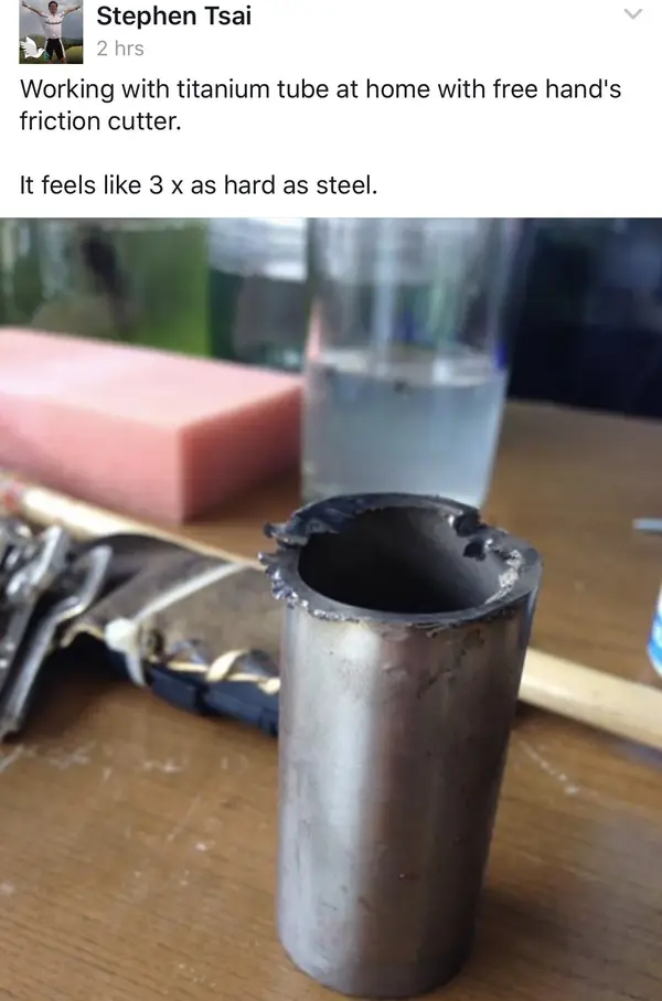

If anybody needs convincing of just how tough titanium bike frame tubing is, try cutting through some with an angle grinder, then try some equivalent steel tubing. Dont forget the safety specs and fire proof suit for the Ti cutting ;)
That is kind of irrelevant as Titanium galls when cutting, which jams the saw by filling the teeth. Therefore it's tough on tools and 6/4 is terrible to work with.
I spent a whole morning cutting off the thin titanium safety cladding from a helicopter gearbox many years ago. My colleagues exploited my 19 year old keenness for what turned out to be a horrible job. :lol:
