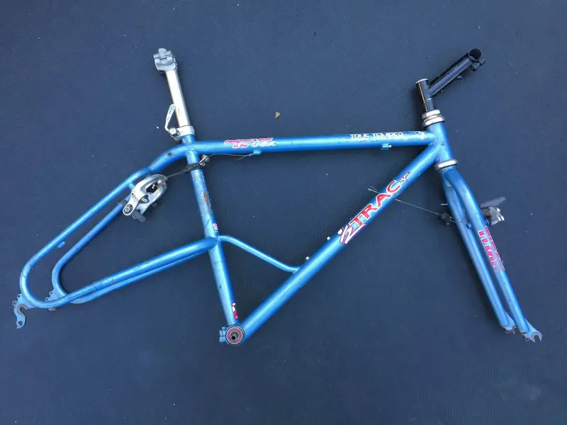

Anyway enough chopsing as we say in Wales. Lots of photos below of the frameset before I start to strip it. These were taken back in early November last year. Slow progress indeed.

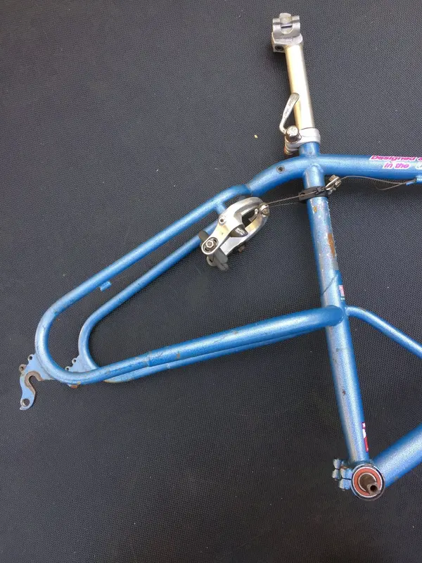

U-brake mounted inside the stays. Not sure we need the Sharks Tooth when it's fitted up there! :) Note the sleeved chainstays and seat tube. No wonder this frame weighs a ton! I wonder how much overlap they have? On a practical note the frameset comes complete with full set eyelets

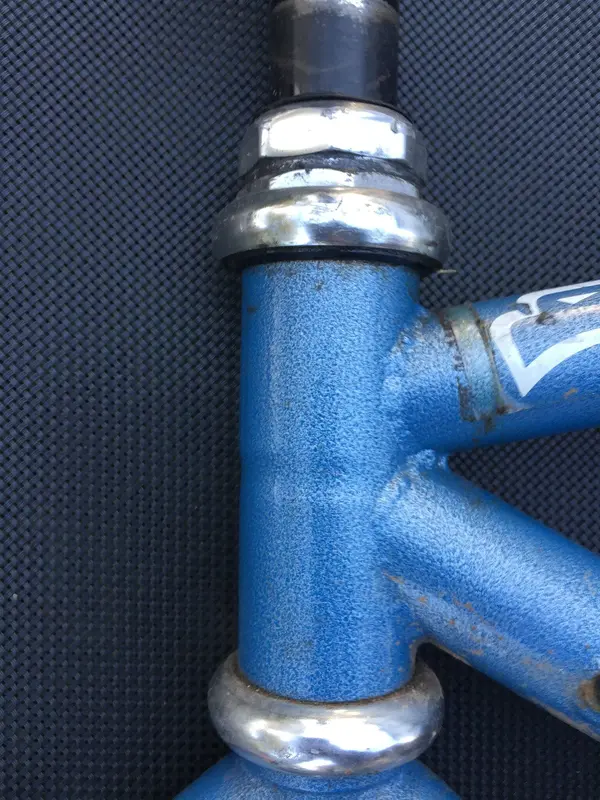

1" 1/4 Headset. Head tube has flared ends. I Haven't taken it apart so it might just be sleeved, but transition looks too smooth to be sleeved based on the detailing on the rest of the frame. No sign of any headtube badge/decal

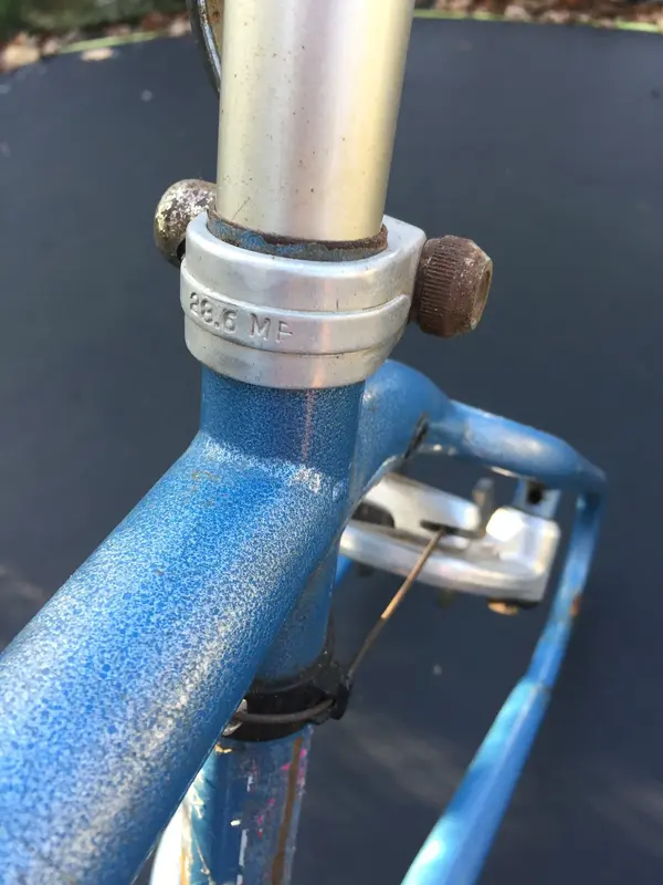

This seat tube collar screams 80s BMX!

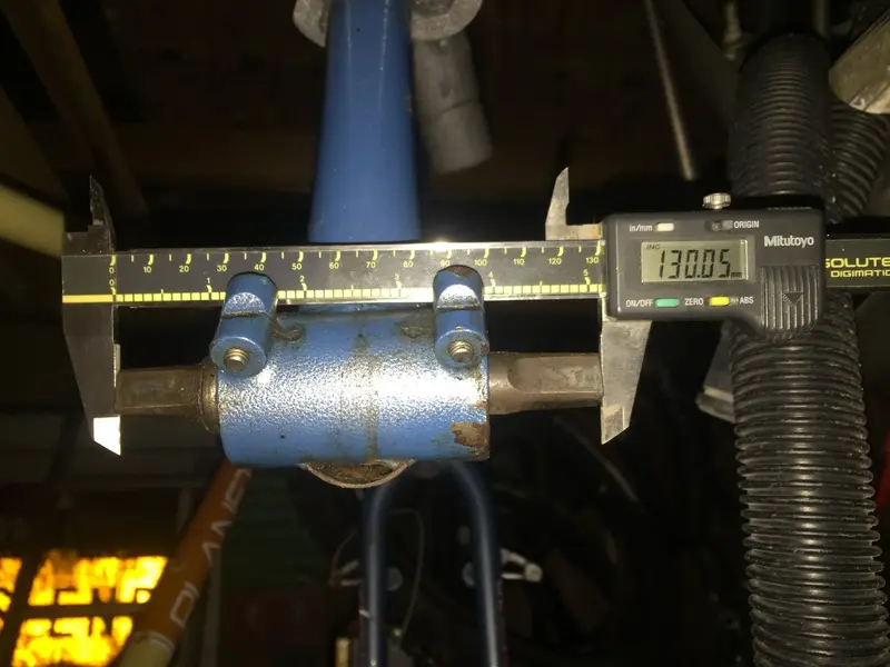

Love this detail! Split BB shell with pinch bolts to keep bearing in place. Note the open end of the downtube and the scored paint on the BB shell. This is because the front derailleur cable runs inside the tube and straight out the end and around the shell itself. Who needs a plastic cable guide?! 😜

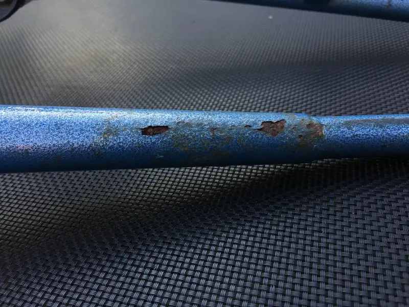

The frame is quite badly corroded in places, but I'm guessing from the sheer weight of this beast we won't have any issues rusted-through tubing. This ain't no skinny-walled Fat Chance!

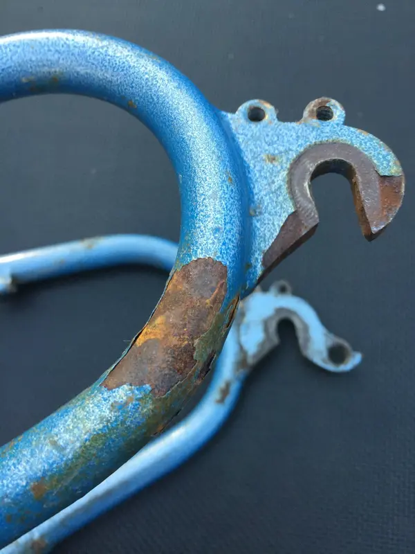

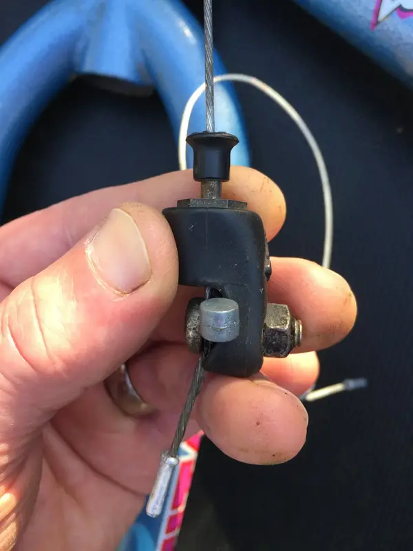

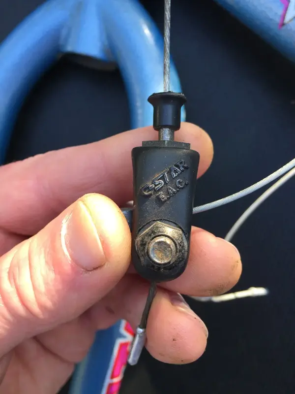

Weird C-Star E.A.C hanger. Has some push-down detail on top. Don't know anything about these so if someone knows something about these please enlighten me. I might use it as it's weirdness matches the bike.

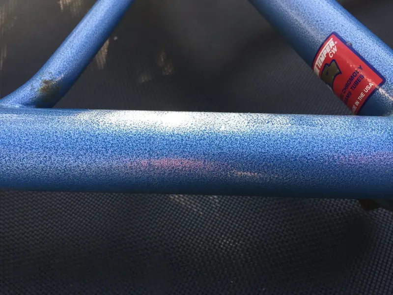

Looks like we should be able to get this industrial Hammered finish to shine a little!
